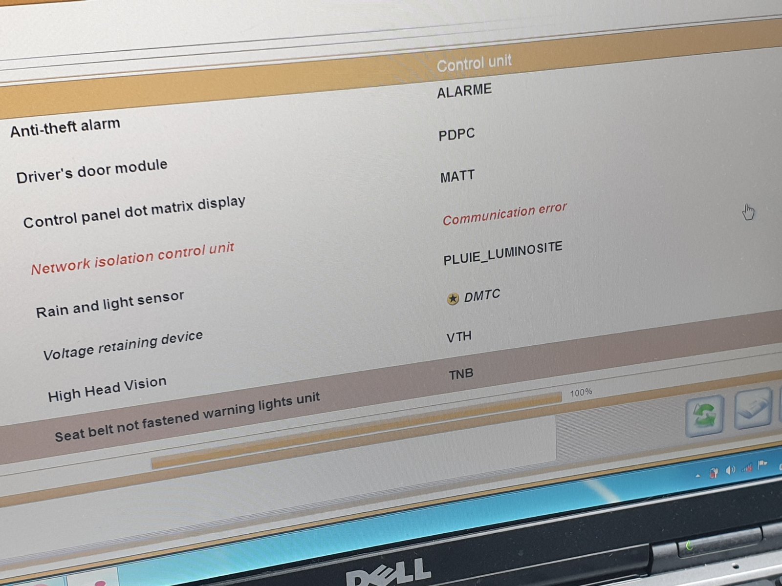

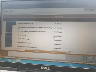

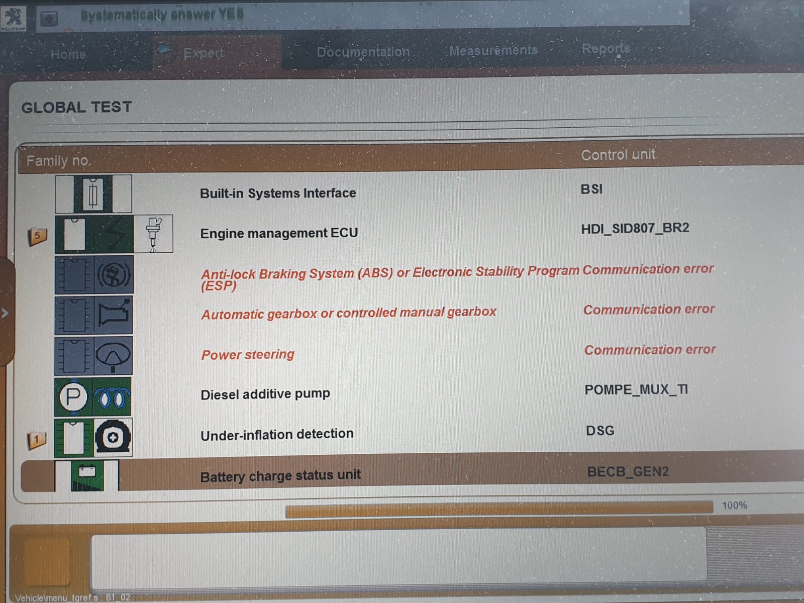

Re: 3008 Diesel. No start. Battery Issue
Post by GF1969 »
Ok. So latest installment.
My battery charger is ancient so bought a smart charger for AGM Stop Start batteries and left it to do its thing.
Next morning its showing the battery fully charged at 12.6V. It doesn't seem enough to me.
Put it on car, do the reset process. Twice. Doesnt start.
Hook up diagbox.
Get communication errors as per pictures.
Take it all out and check main fuses behind the ecu. All good.
Put back on. Do battery reset. No comms again as per pics. At one point the Network Isolation Control Unit was communicating.
Check battery and it's only giving 12.3v
Am I right to be starting to think this battery is faulty? It's only a year old so I can dig out the receipt for a warranty claim.
