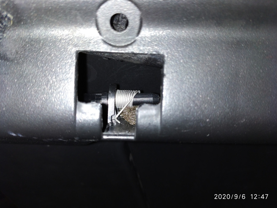

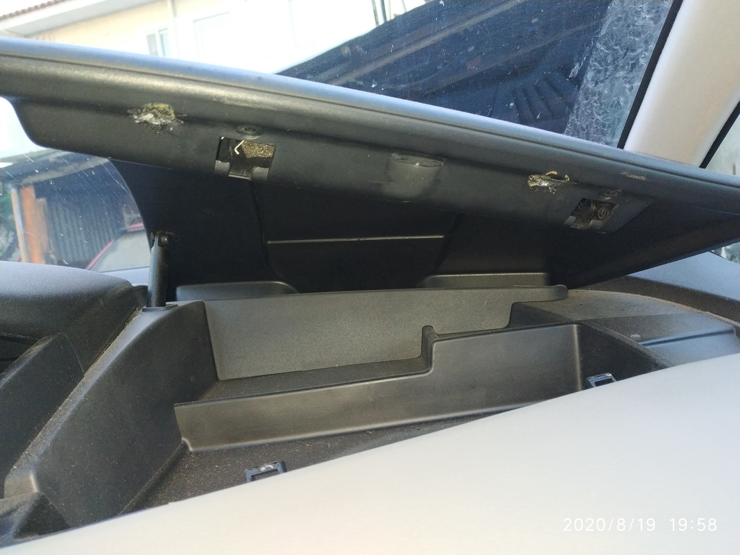

When I bought the car 6 years ago the upper right glove box was closed. I believed that something was broken and I left it as it was. But my son believed that maybe there was a tresure in there so I opened it, finally it had been closed and sealed with some kind of glue.
But now it stays open, so I have to buy a second hand one. The ones that I found look worst than my old one.
So the first question is, can I open and take the mechanism? Or is it "stuck"?
And the second question has to do with the place that you push the button to open, it has around a shinny chromium. Because this chromium usually has problem, can I change it? If yes, how? Does Citroen sell that as a separate part?

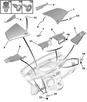

Ok, so these are the parts available.
Let me know which numbers from the diagram that you require part numbers for:

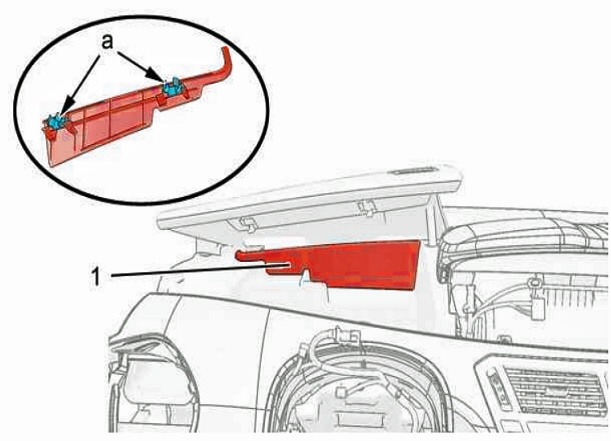

Perform the same operations on the opposite side:
  • Unclip the left-hand upper glove box (1)(at "a") using trim removal tools.
  • Remove the left-hand upper glove box (1)

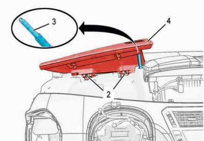

  • Remove the bolts (2)
  • Disengage the left-hand upper glove box cover (4) hinge (3)
  • Remove the left-hand upper glove box cover (4)
  • Remove the hinge (3)

Do we have a spare number for 13? and instructions on how to change it?
x 6945
Re: upper right glove box
Here are the parts in British pounds including our 20% VAT. Prices as of today - there may be a slight difference in your country of course.
There are no instructions for fitting these - but they come as a kit - so must be easy enough to fit. There are 2 types, one with a chromes lever and the other with a black lever - so I have provided you with the left and right part numbers for both designs.
825219 Right (Black Lever Surround) Kit £11.66
825220 Left (Black Lever Surround) Kit £11.66
825221 Right (Chrome Lever Surround) Kit £17.39
825222 Left (Chrome Lever Surround) Kit £17.39
