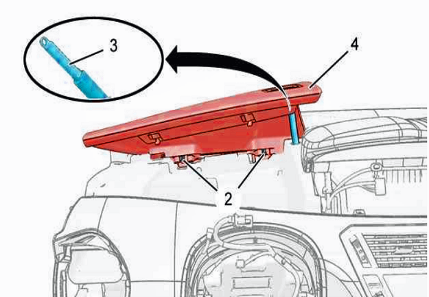

Re: upper right glove box
There is a rear trim piece on the inside rear of the upper glovebox that needs to be removed with trim tools to reveal 2 bolts. Undo these and disconnect the hinge from the upper cover. The you can remove the cover.

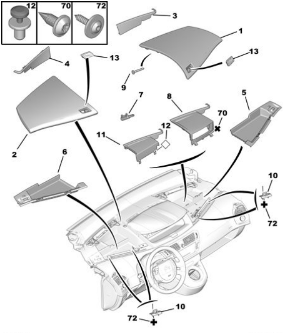

Ok, so these are the parts available.
Let me know which numbers from the diagram that you require part numbers for:
This is all I have on removal:
Perform the same operations on the opposite side:

thanks Marc
Do we have a spare number for 13? and instructions on how to change it?
Here are the parts in British pounds including our 20% VAT. Prices as of today - there may be a slight difference in your country of course.
There are no instructions for fitting these - but they come as a kit - so must be easy enough to fit. There are 2 types, one with a chromes lever and the other with a black lever - so I have provided you with the left and right part numbers for both designs.
825219 Right (Black Lever Surround) Kit £11.66
825220 Left (Black Lever Surround) Kit £11.66
825221 Right (Chrome Lever Surround) Kit £17.39
825222 Left (Chrome Lever Surround) Kit £17.39
