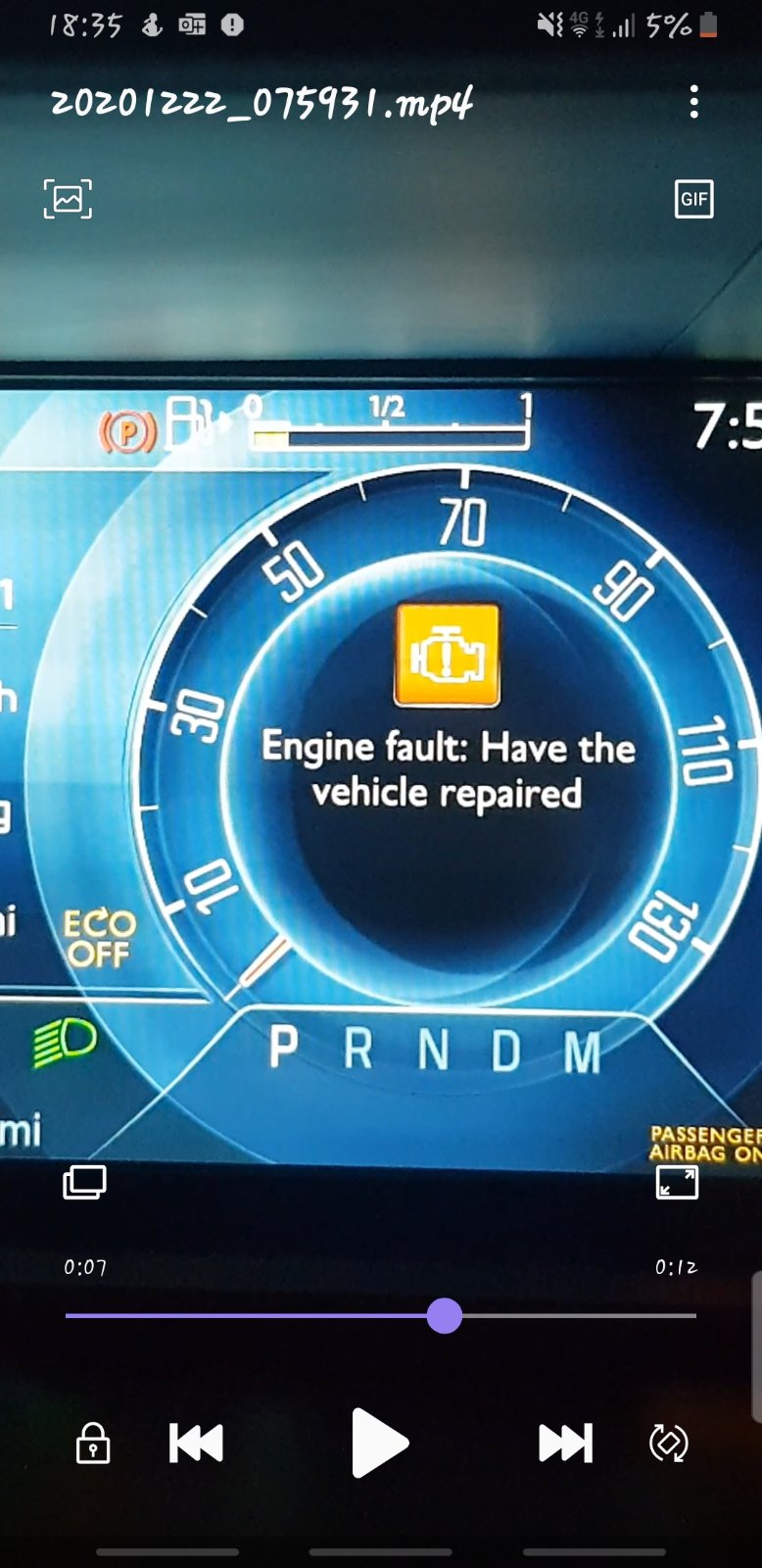

i have a citroen c4 grand picasso 2015 ex+ 2.0 bluehdi, recently the car show an orange fault when i start it in the morning( it does show every tim) <engine fault have the vehicle repaired with flashing eco in orange colour. after that it doesn't show for rest of the day.
the eco mode doesn't work when i stop rather it flashes green three times everytime i stop, the battery test shows very good.

i have taken the car to citroen dealer for diagnosis and this is what they say: Carried out checks into engine warning, found faults related to central voltage maintaining device. Need to carry out checks to all earths, batter & connections. If all ok advise softwear download & recheck for further faults. If still present will require a cnentral voltage maintaining ecu.
in my point of view the fault seems not too serious as it shows only when the car is cold.
