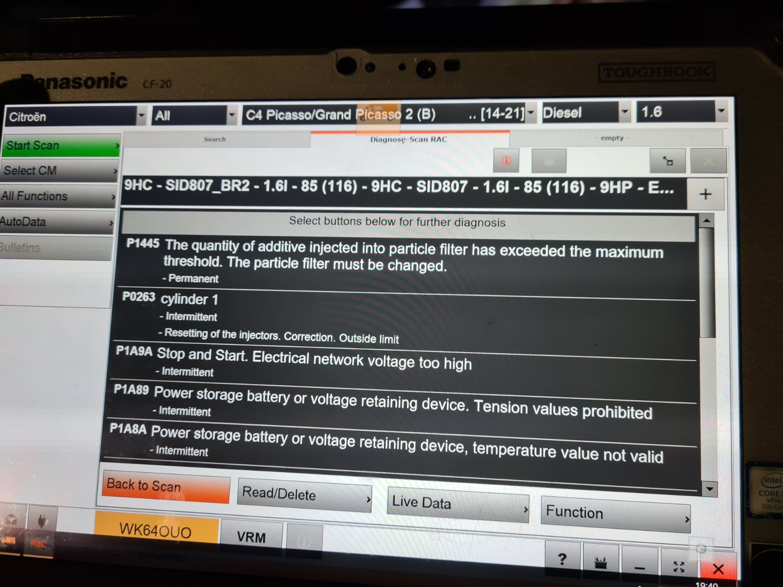

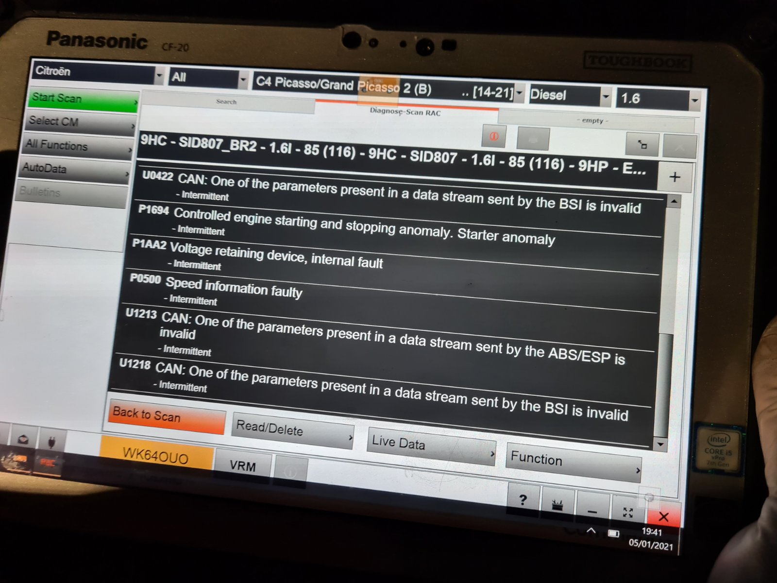

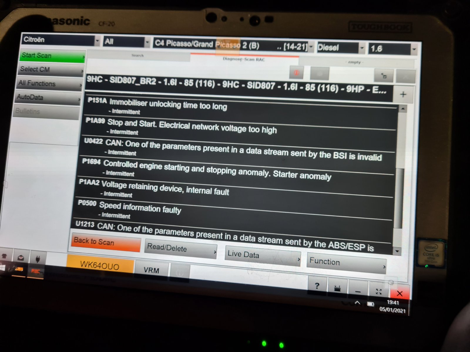

Anyway, I drove my Grand Picasso to my job 5 mins down the road after being unsuccessful and was there for 8 hours. I hopped back in the car and it wouldn't start. The dash, head lights and indicators kept flashing on and off and came up with a message saying "Engine Fault - arrange repair" along with an engine & battery light on the dash. It eventually started and ever since has always started, but comes up with the same engine message. Later that day when the RAC came for the van I cheekily asked him to plug his diagnostics into my citroen and search the fault codes. I have pictures of them all and got them cleared afterwards so I know which faults are new, but there were multiple "intermittent" faults relating to "storage battery or voltage retaining device" values invalid or parameters not met and "Stop and start. Electrical network voltage too high". There was also a permanent fault which said the additive injected into DPF exceed maximum threshold and the PDF must be changed, but that's a separate issue I believe.

Here are the fault codes which came up. Don't know how old they are or if they were ever sorted.

Ok, so I've had a quick check and unfortunately I don't have all the details on this specific engine ECU, but P1AA2 does imply a fault with the Central Voltage Maintaining Device.
When charging the batteries on these vehicles with the Stop & Start and these devices, the battery needs to be charged SLOWLY to avoid a charging fault message on starting the engine. Testing will involve checking that the ECU software for this device has been updated to the latest version and if it has, a check of the gearbox, body and engine earths. Then the Central Voltage Maintaining Device bolts need to be checked for tightness and finally if this does not sort out the warning, the recommendation form Citroen is to replace the Central Voltage Maintaining Device.
So I suspect that there may of been some damage caused when connecting to the other vehicle whilst the engine was running.
