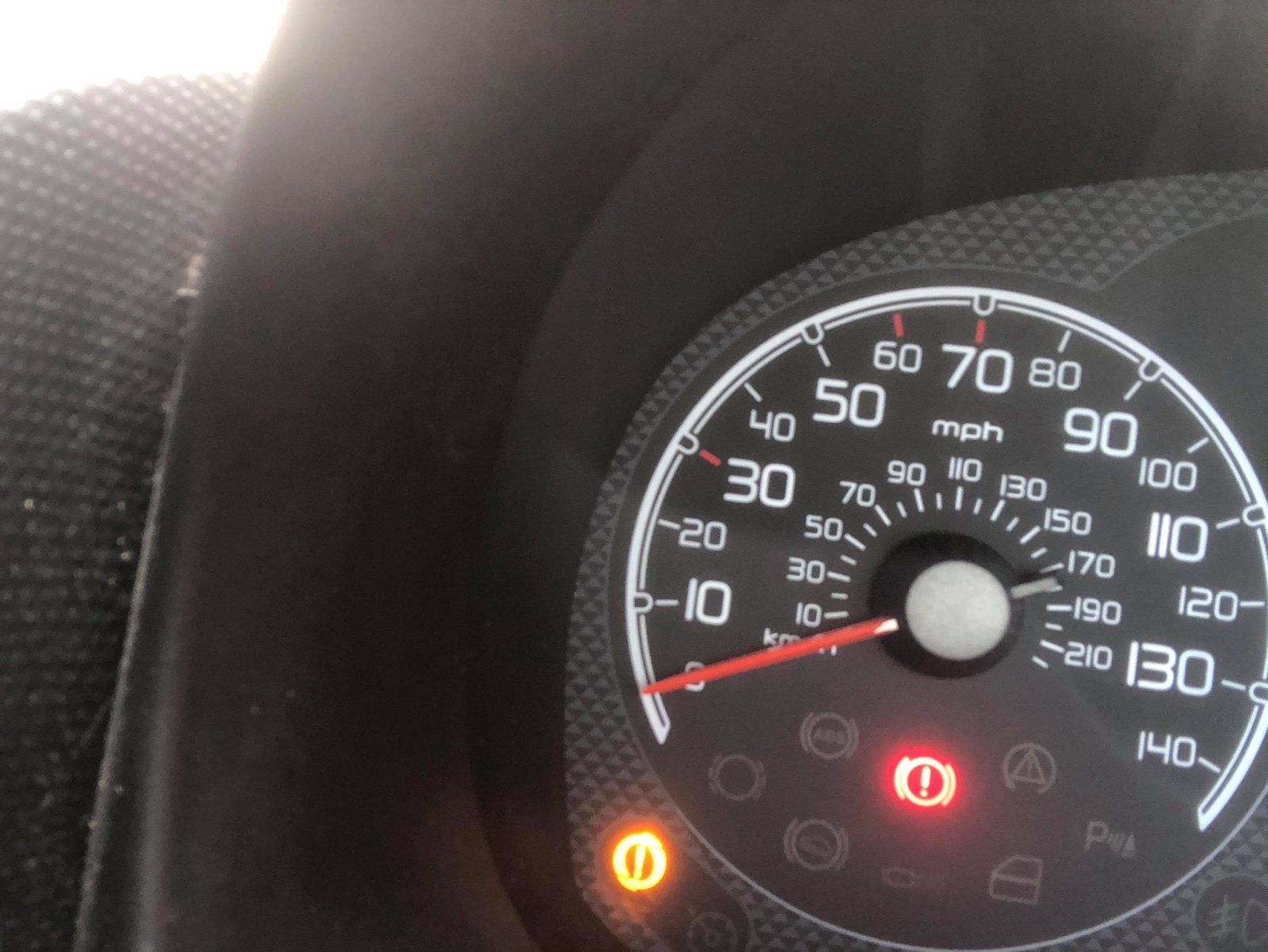

Afternoon Everyone,
I have a 2011 Citroen Nemo, It runs ok the majority of the time and then seemingly out of the blue the EML will come on in addition to this second light, which I am unsure as to what it means, can anyone shed any light? When this happens the engine goes into limp mode.....
The picture is a little unclear but its essentially 2 orange arrows forming a circle around an exclamation mark, it is located at the bottom left of the speedometer, this problem only occurs at low revs in the lower gears :?: :?: :?:
Tim
x 6945
Re: What is this warning light??? Citroen Nemo
I've checked the technical info on this and there doesn't seem to be a warning in the lower left shown - however the red one can be wither the handbrake is not properly released or low brake fluid warning - so I'd obviously check that first of all.

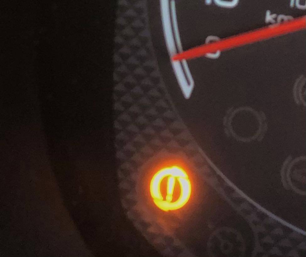

Thank you very much for the reply, unfortunately it doesn't seem to be either of those things. I've attached another close up of it, it may not even be related to the eml issues, all i know is that they both come on at the same time. Kind Regards

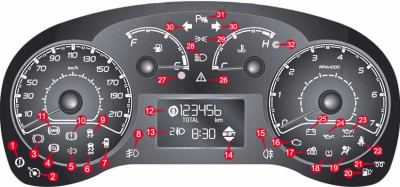

Punto dash lights:
The only one I have seen appears to indicate worn brake pads - a circle with arrows as described.

ive actually just figured it out, the dash in the nemo is from a fiat doblo
https://www.dash-lights.com/fiat/doblo- ... ng-lights/
and the light is "Warning light name: Fiat Doblò start stop failure warning light.
Description: This amber warning light illuminates when a fault with the automatic engine start stop system has been detected."
Which i guess makes sense, because when the EML comes on the start/stop is deactivated. So I guess the question is now...
Why is the EML coming on? Ive had it looked at by a garage and they think that because it was standing for a while prior to me buying it, it might be something to do with the egr valve...? Im currently running a bottle of cataclean through it to see if that makes a difference? However, he said that his diagnostic machine thingy (technical term) could pick anything up? Does anyone know the correct diagnostic equipment for this job?

Yes these are all fiats - not much Citroen about them. But as I said, the available Citroen tech info does not cover this particular warning light anywhere in the instrument panel data, so I was only referring to the red warning lamp and the associated info if illuminated.
