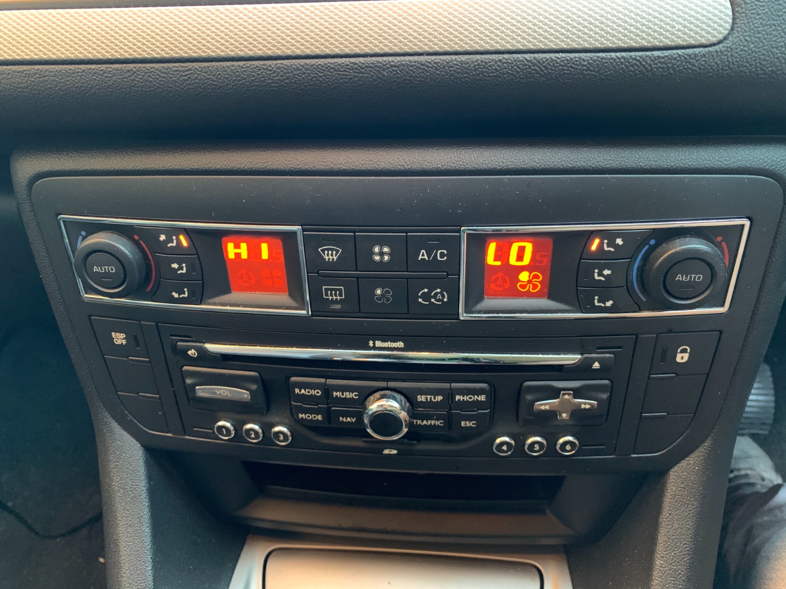

My vin is VF7**************[VIN obfuscated, can be read by forum staff] and I have included a pic of my climate control unit.
The problem is when I turn the adjuster on the right of the photo it doesn’t change the temperature. The temperature stays on low but it should increase.

That's a dual zone system and looks suspiciously like the climate control panel itself may be faulty. If the climate ECU contained inside the panel shown is malfunctioning, then it won't send the commands to adjust the air mixing (temp.) or air distribution settings to the stepper motors. As the dial would seem stuck on the setting shown, it might be that the ECU is ok, but tracks on the dial have become worn - more so because it's the driver's side that tends to get more use....stagsmad wrote: 31 Dec 2020, 15:08 Hi Marc
Cheers
So not sure what you can do - whether taking it apart and trying to clean the tracks about the dial or look for a replacement. These climate control panels are currently £540.46 inc. VAT from Citroen
So have a look for a second hand one.

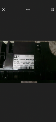

I’ve found this on ebay

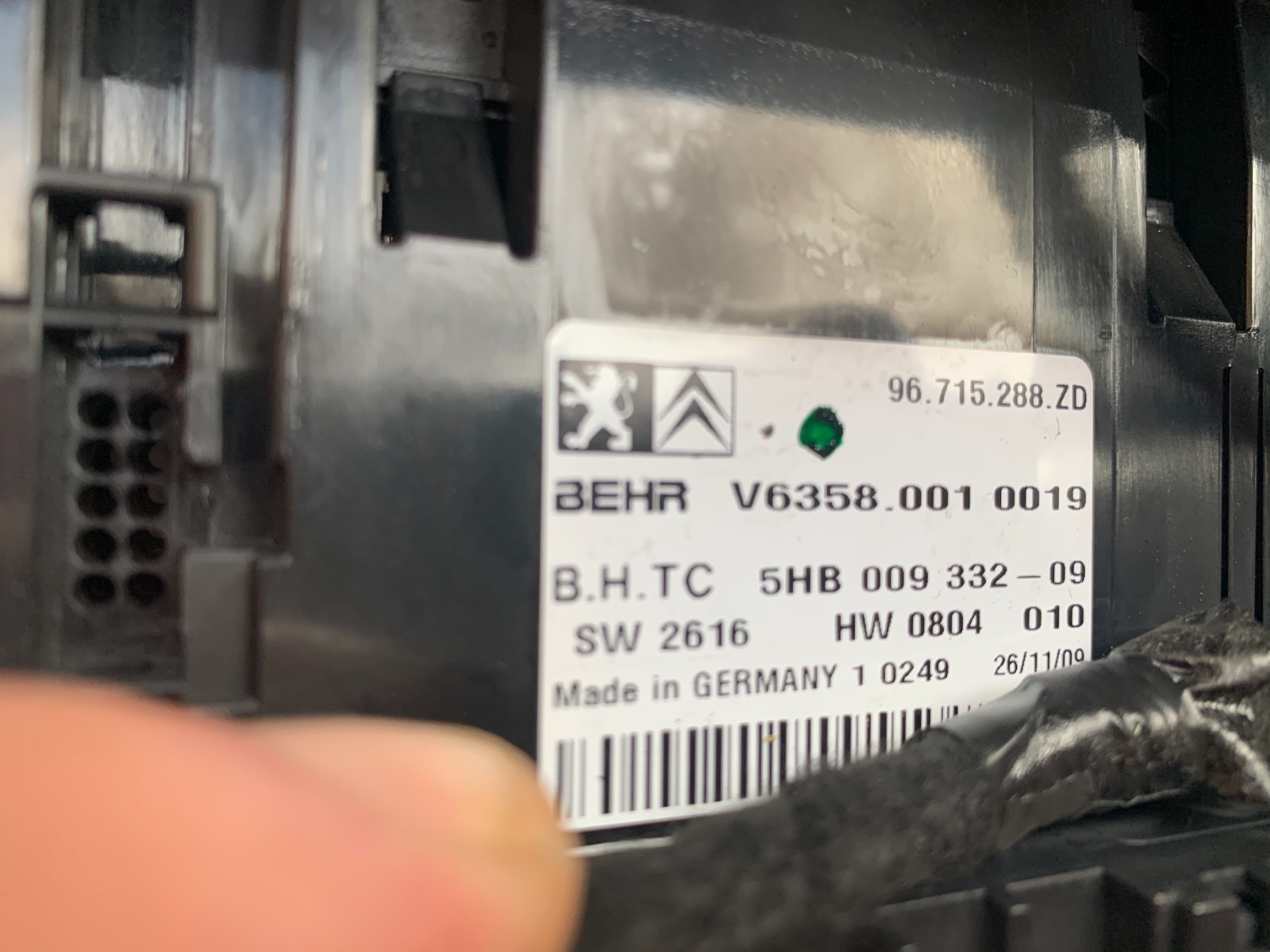

mine is the one with the sausage finger on the photo
Are they the same or do I need the same reference number.
Cheers
Cheers

The number Marc posted (and which I used in the ebay search) is the one you want. If it is not a match it will not work.
- x 6957
Re: Climate control faulty 2009 C5 VTR NAV +
Those look different to me (physically as well as part number wise). I gave you the Citroen internal part number, but as you have posted your photo, use the same external part number: 96715288ZD
Here's one with the same part number:
https://www.ebay.co.uk/itm/CITROEN-C5-I ... 2772569538
