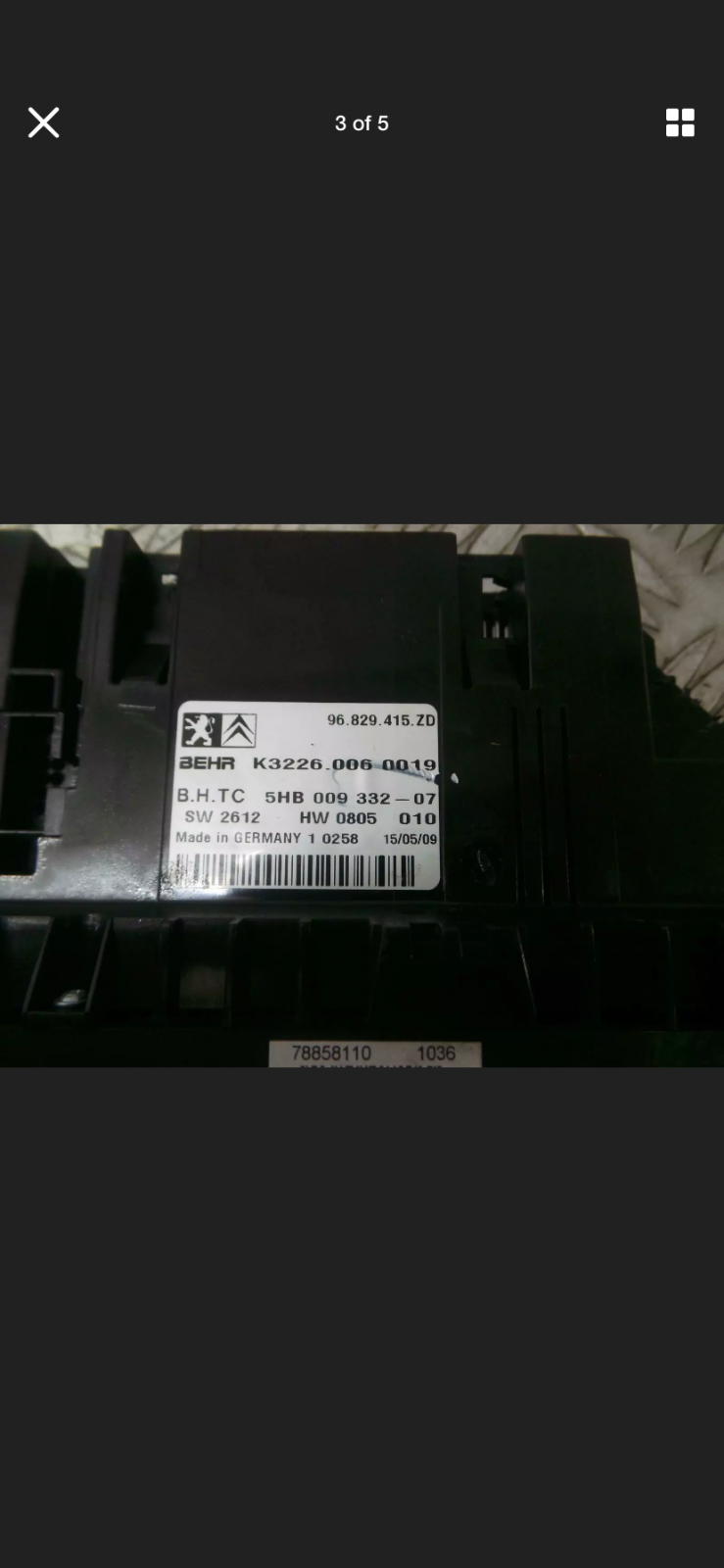

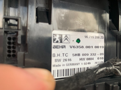

I’ve found this on ebay
mine is the one with the sausage finger on the photo
Are they the same or do I need the same reference number.
Cheers

Re: Climate control faulty 2009 C5 VTR NAV +
The number Marc posted (and which I used in the ebay search) is the one you want. If it is not a match it will not work.
Those look different to me (physically as well as part number wise). I gave you the Citroen internal part number, but as you have posted your photo, use the same external part number: 96715288ZD
Here's one with the same part number:
https://www.ebay.co.uk/itm/CITROEN-C5-I ... 2772569538
