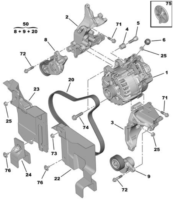

It also turns mechanical energy into electrical energy and electrical energy into mechanical energy. In order to ensure there is always backup power for the safety systems to operate on Stop / Start systems, there is also a large capacitor that stores the electrical energy created through regenerative braking and from deceleration.
Your alternator should be a 180A unit, part: 5705PA (new) item (1) below, or 1625944380 for an exchange unit from Citroen. These are Valeo.

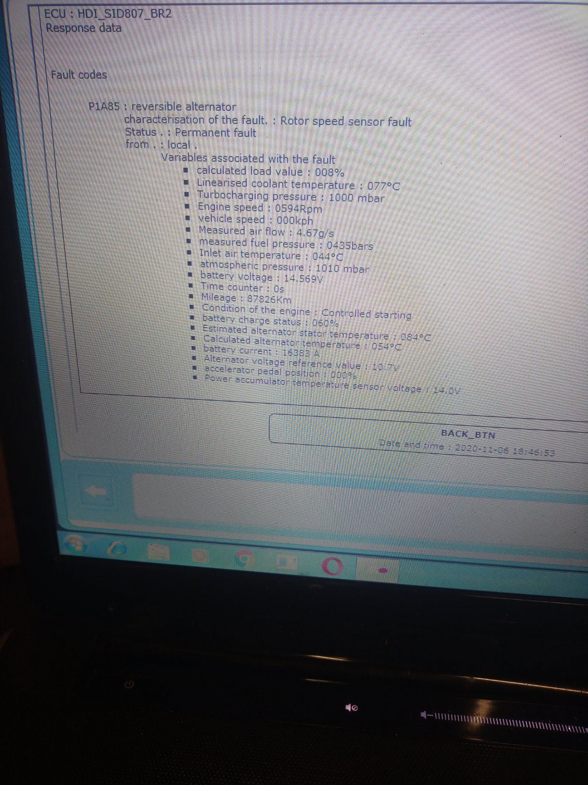

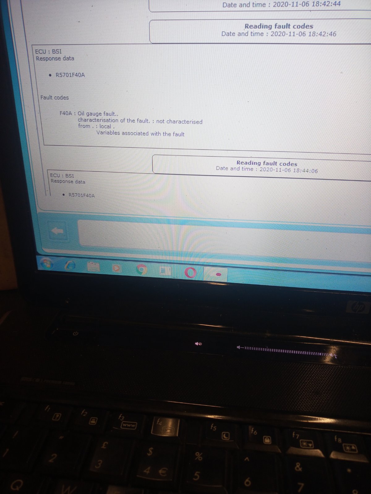

Re: Alternator problem
Here is the screen which stays after i cleared all others which were all can faults, i believe the battery was too low and then caused the others also the oil gauge one, but dont think is related
Did you change the alternator yet? If the fault code P1A85 is still there then that points to the alternator. And I note your Battery charge was 60% - I assume that was before you changed the battery - but regardless, if the alternator is faulty it may not be charging the battery anyway.....
