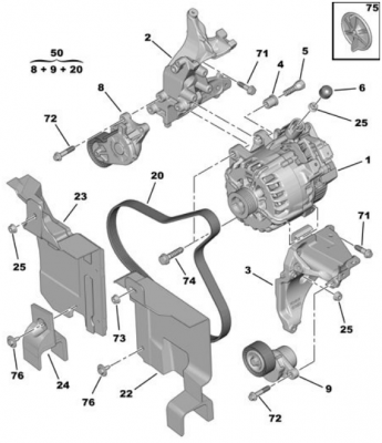

Re: Alternator problem
You have a Stop Start system, so a a reversible alternator is used. This provides the combined function of a starter and an alternator in one. It ensures the engine can be rapidly started.Wawpeyo wrote: ↑06 Nov 2020, 19:17 Hi, here i come with another issue, peugeot 308 VF3**************[VIN obfuscated, can be read by forum staff]
I forgot the fault code just now, but it came as reversible alternator speed sensor fault.
Wtf is a reversible alternator?
Really this have one?
At the moment not charging the battery and no other faults.
I have to suppose any alternator wint will do?
Whats the part number for it?
Cant really see the alternator so i will have to search for it.
This time lets try to make it short so all the questions in one.
It also turns mechanical energy into electrical energy and electrical energy into mechanical energy. In order to ensure there is always backup power for the safety systems to operate on Stop / Start systems, there is also a large capacitor that stores the electrical energy created through regenerative braking and from deceleration.
Your alternator should be a 180A unit, part: 5705PA (new) item (1) below, or 1625944380 for an exchange unit from Citroen. These are Valeo.
The capacitor is usually stored behind one of the wings - but be very careful about touching these as they are obviously highly charged and must be discharged before removing or handling (not that you should need to at present).
Reversible alternators can wear out a bit quicker as they are doing 2 jobs and are in constant use.
Again, if you have any fault codes relating to this , put them up now.
