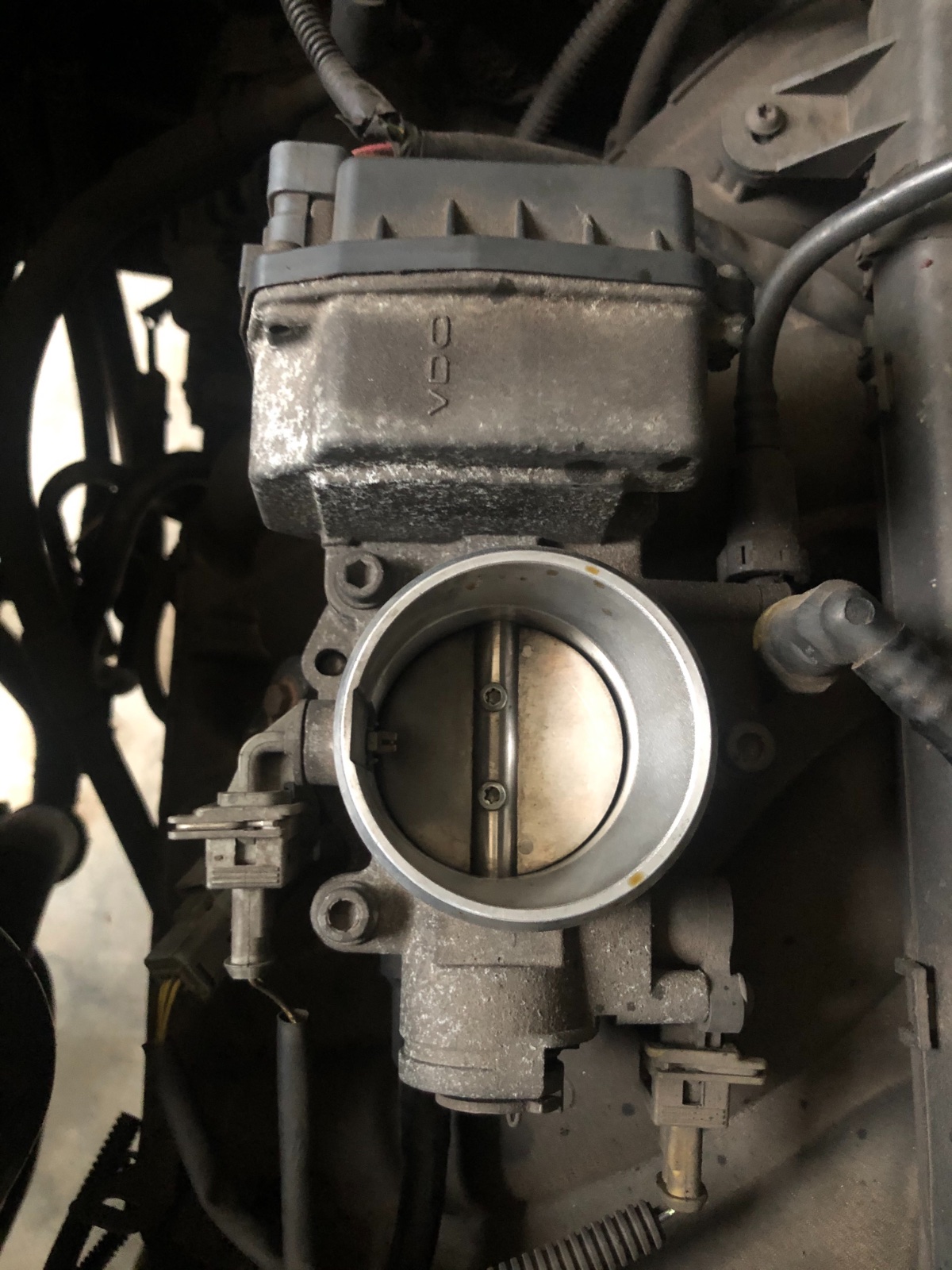

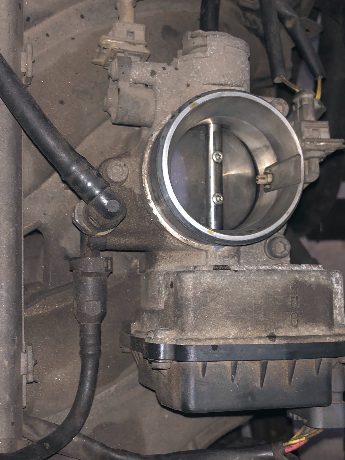

To my understanding, the motorised throttle body has the motor integrated;
this is what it looks like in my car (and I can't reconcile this with what's in the parts diagram / the pictures) - the block on the left is the motor, right?

Ok, what you have in your pictures is the Air Intake Throttle Valve Housing, item (8).
Part 1635S7, currently priced at £344.93 inc. VAT from Citroen. :-D
