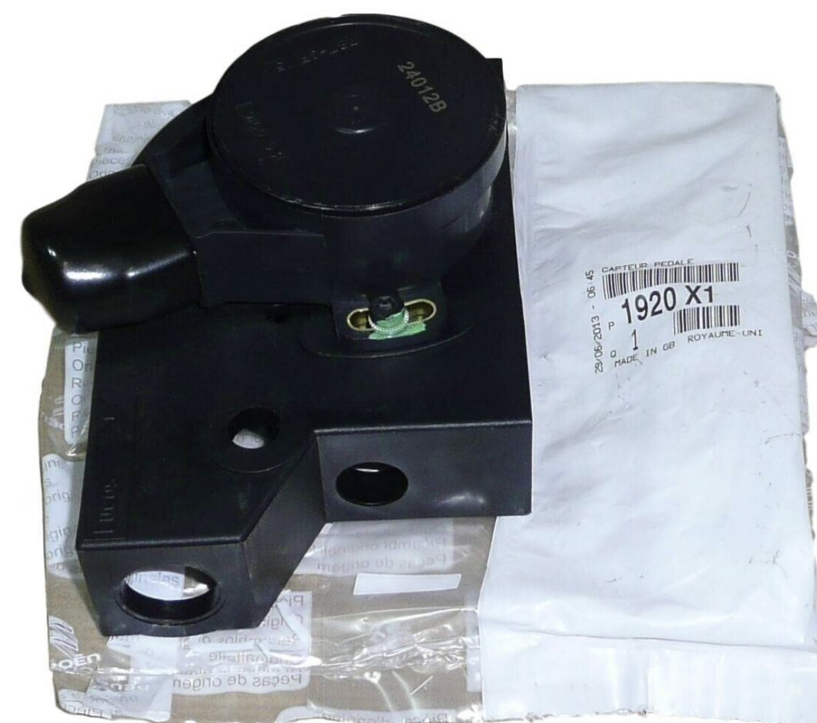

Ok, so the part number for item (3) is 1920X1.
There's another part that it mentions: 1608878580 alongside the above. Anyway I've put pictures for both below.
I'm sure you'll know what you need.

Part 1920X1
£339.00
Part 1608878580
£90.90

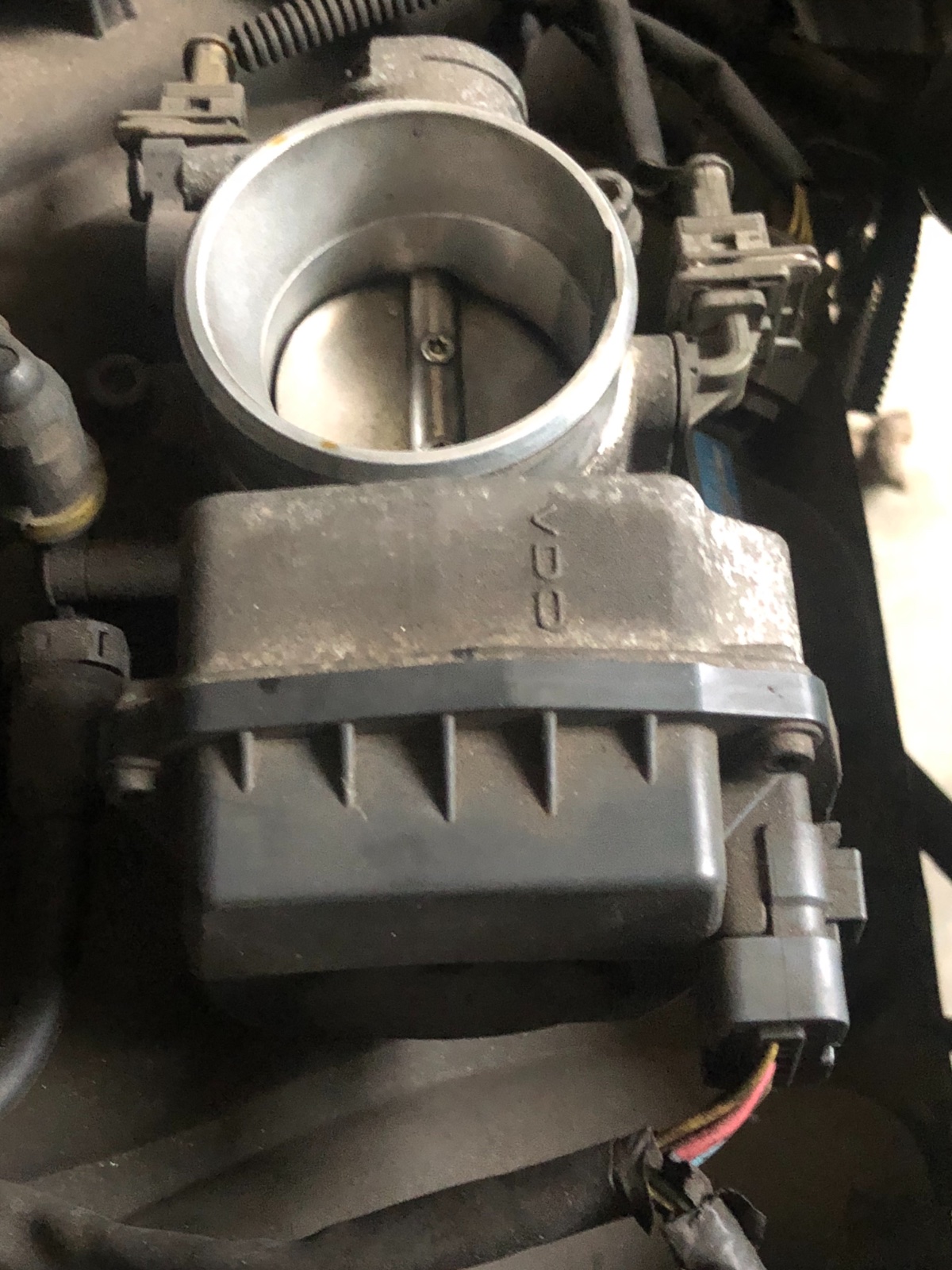

To my understanding, the motorised throttle body has the motor integrated;
this is what it looks like in my car (and I can't reconcile this with what's in the parts diagram / the pictures) - the block on the left is the motor, right?

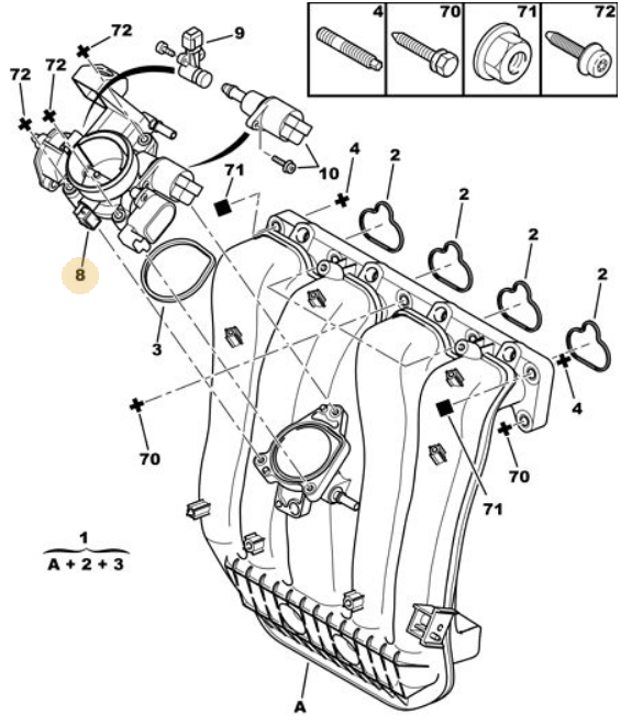

Ok, what you have in your pictures is the Air Intake Throttle Valve Housing, item (8).
Part 1635S7, currently priced at £344.93 inc. VAT from Citroen. :-D

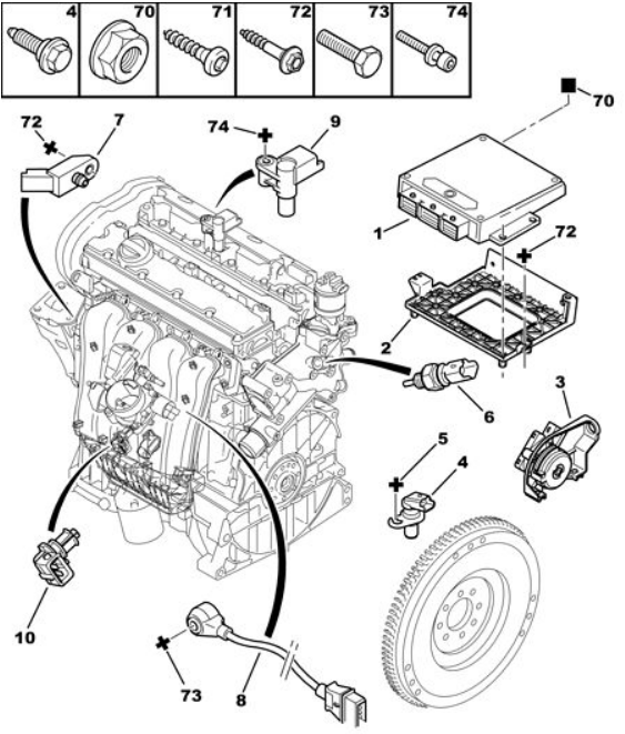

(10) is the Air Intake Temperature Probe (19204G) You can get a Magneti Marelli one of these for about £12
(7) is the Air Intake Pressure Sensor (457403). You can get a Magneti Marelli one of these MAP sensors for 18.59.

That's interesting; what I've replaced is 7; from a car being broken for parts, so hopefully was an original part (although maybe that owner had an aftermarket part to begin with). Many years ago when I got the car, the garage tried swapping the sensor with another car and the issue persisted, so they felt it wasn't actually a problem with the sensor at all - and indeed the change in 2017 didn't change it;
Should I try 10? Or 10 and 7?
