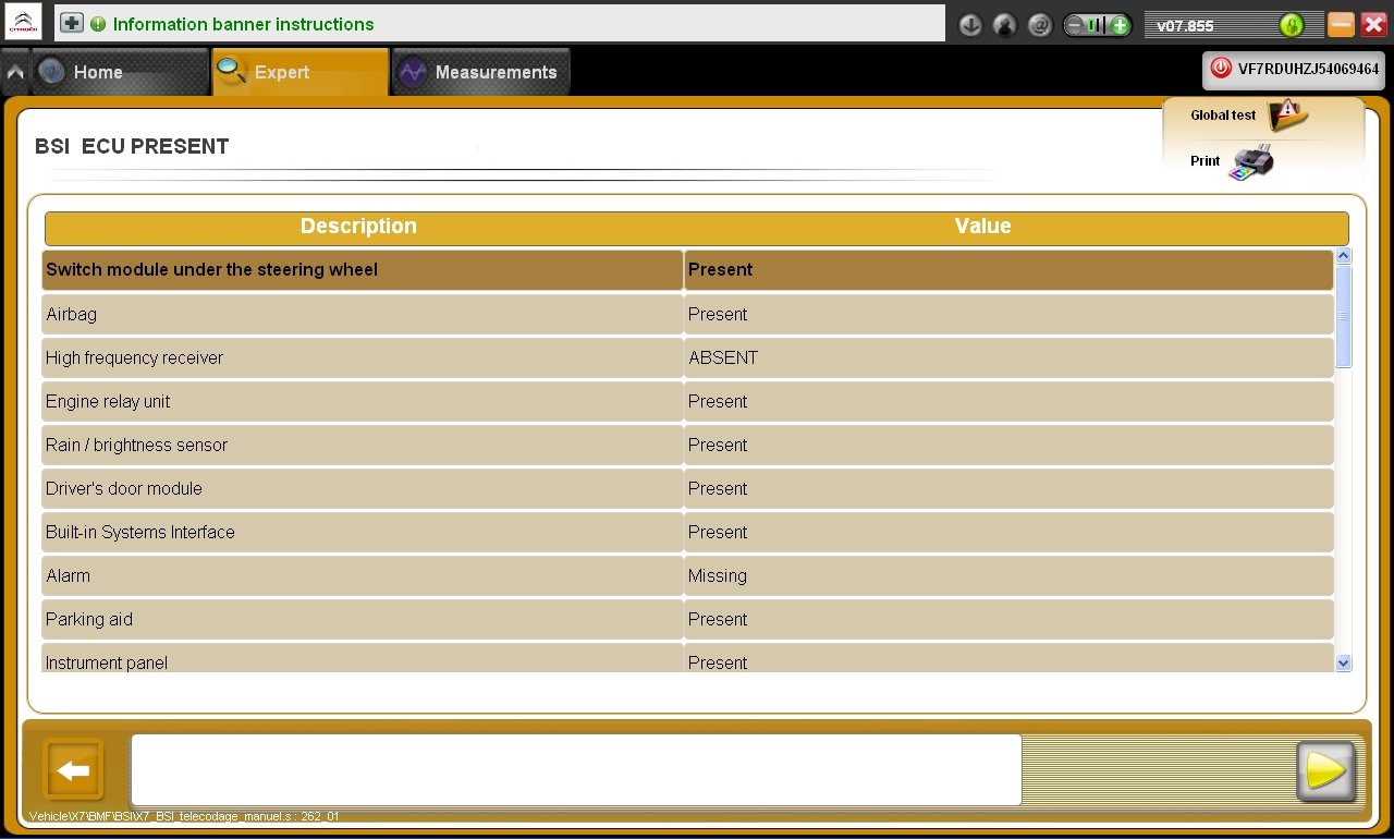

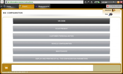

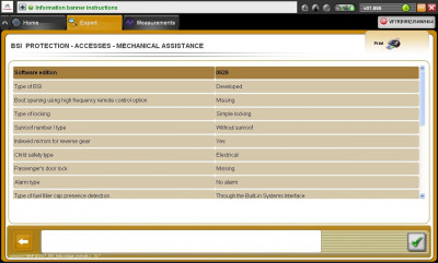

Marc; I have problem to find the right page for you. Can not find the "BSI option/ Configuration parameters" but I take some photos which I assume to be important
- VIN: VF7**************[VIN obfuscated, can be read by forum staff]
Send the pictures in next message...

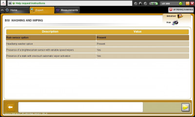

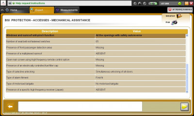

Unread post by Mhirvi »

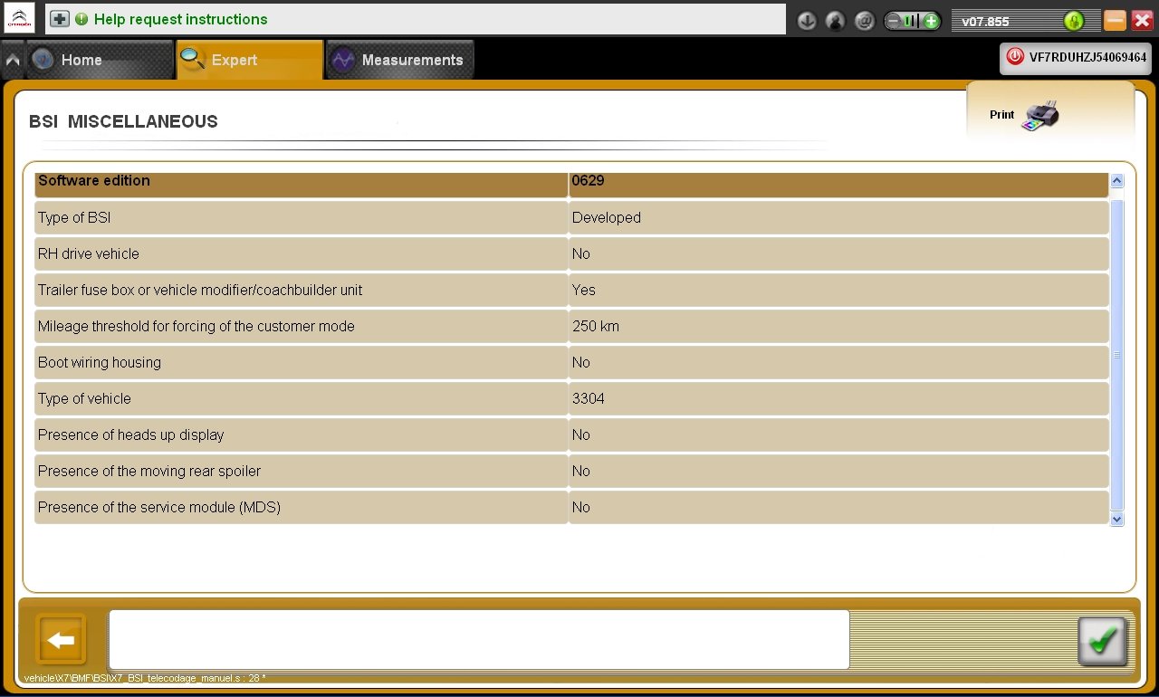

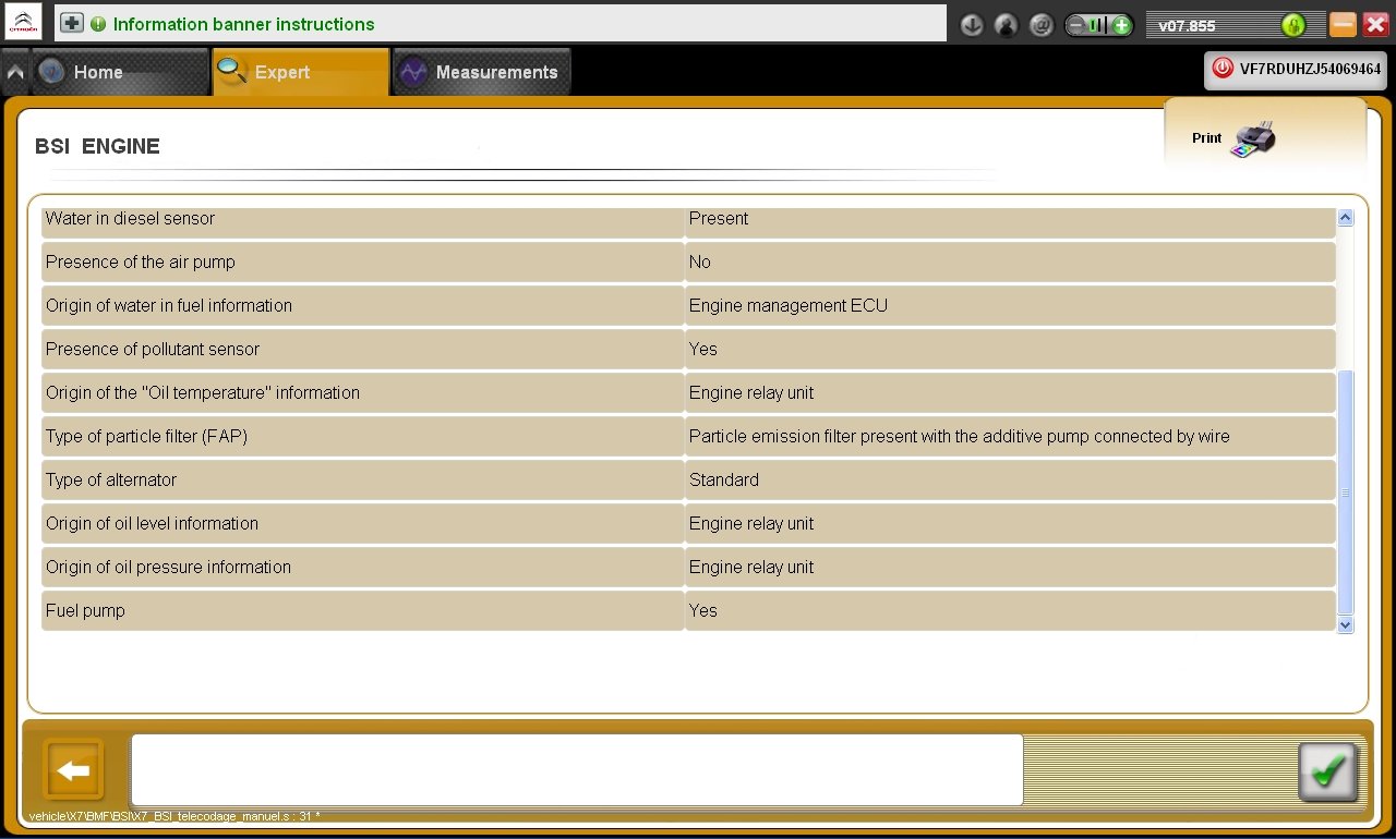

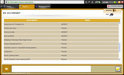

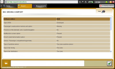

Here is some pictures, hope they help...
Please inform me where to look, if you need more information.
/Markku

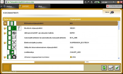

Re: RD4 to eMyWay/RT6 swap problem
Markku - I'm sorry, but I don't have time to translate all these - it will take far too long. If I'd known these were going to be in Finnish (?) I wouldn't have requested them - sorry.

It is Finnish.
I will change the language and take new pictures.
- I soppouse, I can then find the "configuration parameters" pages better :)

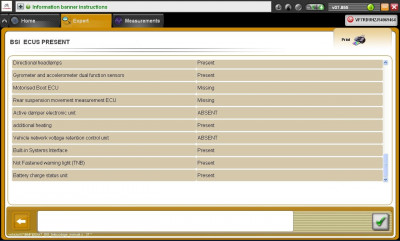

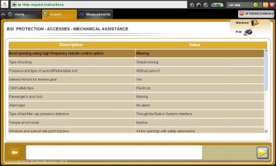

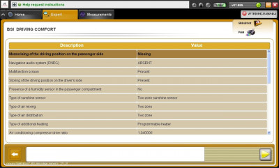

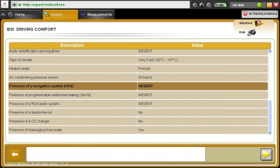

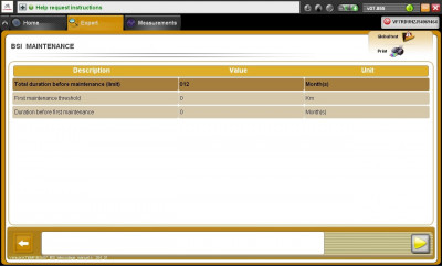

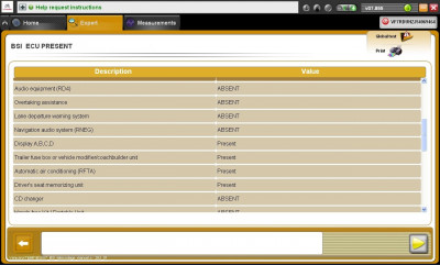

If you are in the BSI section, just do exactly what you did above - just capture each page so I can see the options and what your current setting is. That's the quickest way for me to try and help. The screen shots that you have done above are perfect - for the BSI - just the wrong language for me :)

Hi,
These are the pictures under BSI- section.

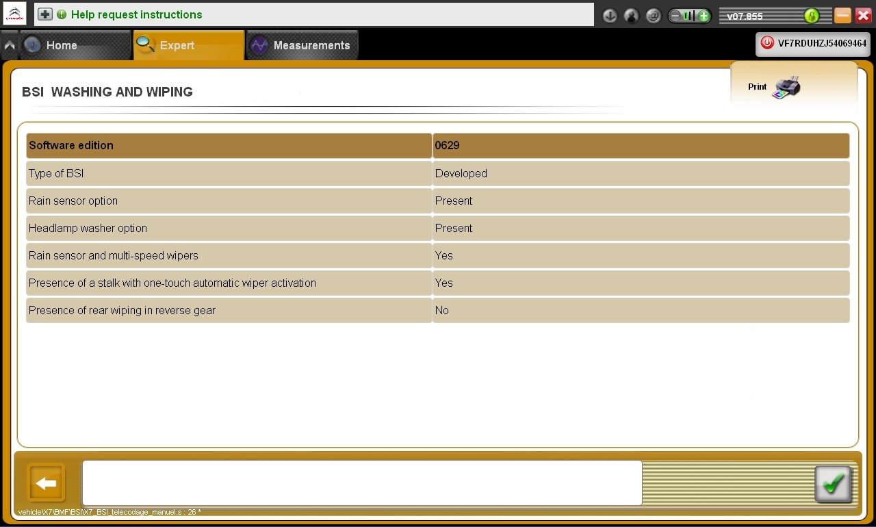

I send them in 3 posts
And this is the last set.
