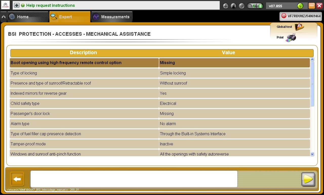

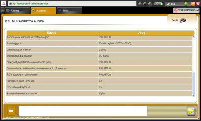

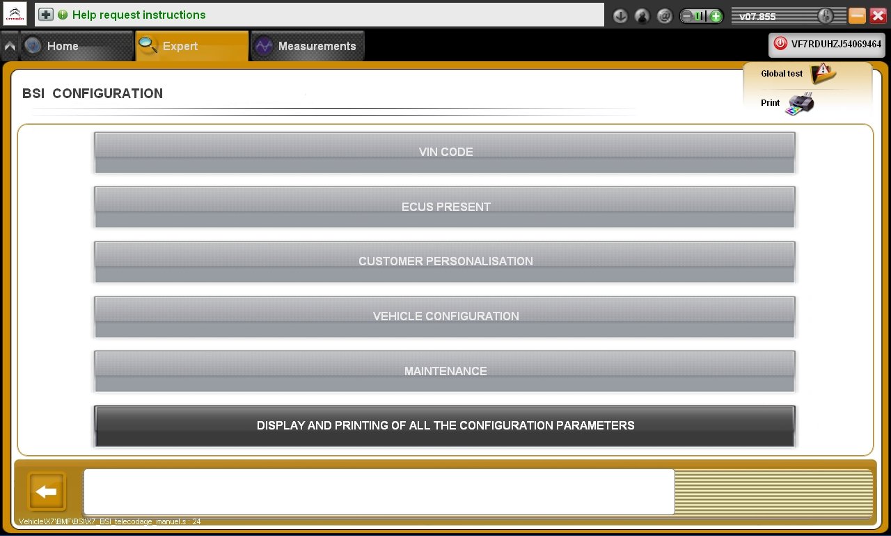

Marc; I have problem to find the right page for you. Can not find the "BSI option/ Configuration parameters" but I take some photos which I assume to be important
- VIN: VF7**************[VIN obfuscated, can be read by forum staff]
Send the pictures in next message...
Mhirvi
Posts: 19
Joined: 02 Aug 2020, 14:10
Re: RD4 to eMyWay/RT6 swap problem
Unread post by Mhirvi »

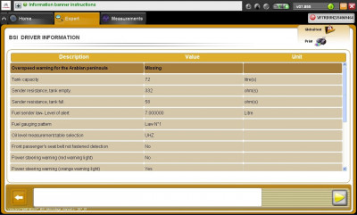

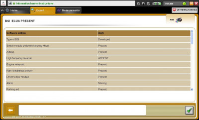

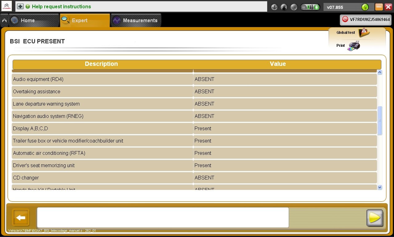

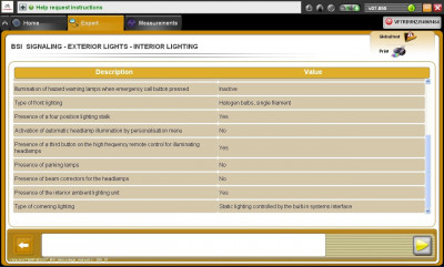

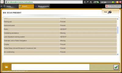

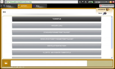

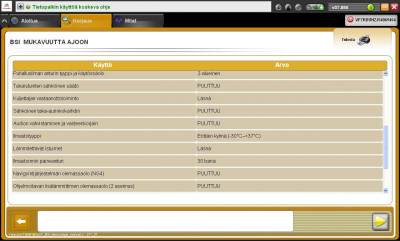

Here is some pictures, hope they help...
Please inform me where to look, if you need more information.
/Markku

Markku - I'm sorry, but I don't have time to translate all these - it will take far too long. If I'd known these were going to be in Finnish (?) I wouldn't have requested them - sorry.
If you want to try and temporarily change the language you can. If this is actually Finnish - clarify with me first before doing this change, as this is assuming it is Finnish:
Make sure Diagbox is closed.
1) Open the File Explorer and navigate to "C:\AWRoot\dtrd\trans\" and locate the file 'Language.ini' file.
2) Don't open it yet - first make a copy of it. I suggest you copy the file and rename the copy to 'Language.org'.
3) Open the 'Language.ini file' using Notepad and locate this section:
[LANGUAGE]
4) If it is in Finnish, it will have an entry of: "Current=fi_FI"
5) If this is the case, then change 'fi_FI' to 'en_GB'.
6) Save the file.
7) Restart the laptop
8) Open Diagbox and see if it is now in English
You can revert back by reversing the above changes, or by deleting the 'Language.ini' file and then renaming the 'Language.org' file back to 'Language.ini', and restarting the laptop.
This has been tested in various versions of Diagbox 7.7*, but as always this is just a suggestion and there are no guarantees - so at your own risk.

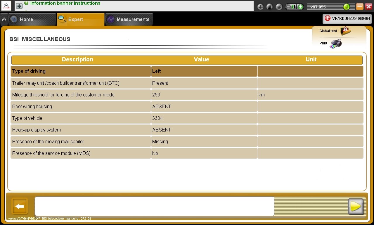

Posts: 42019
x 6955
If you are in the BSI section, just do exactly what you did above - just capture each page so I can see the options and what your current setting is. That's the quickest way for me to try and help. The screen shots that you have done above are perfect - for the BSI - just the wrong language for me :)

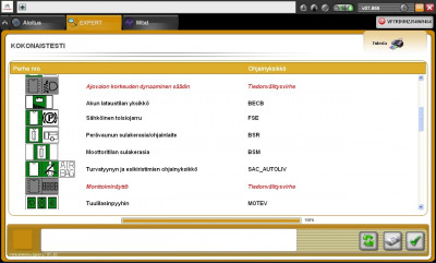

Hi,

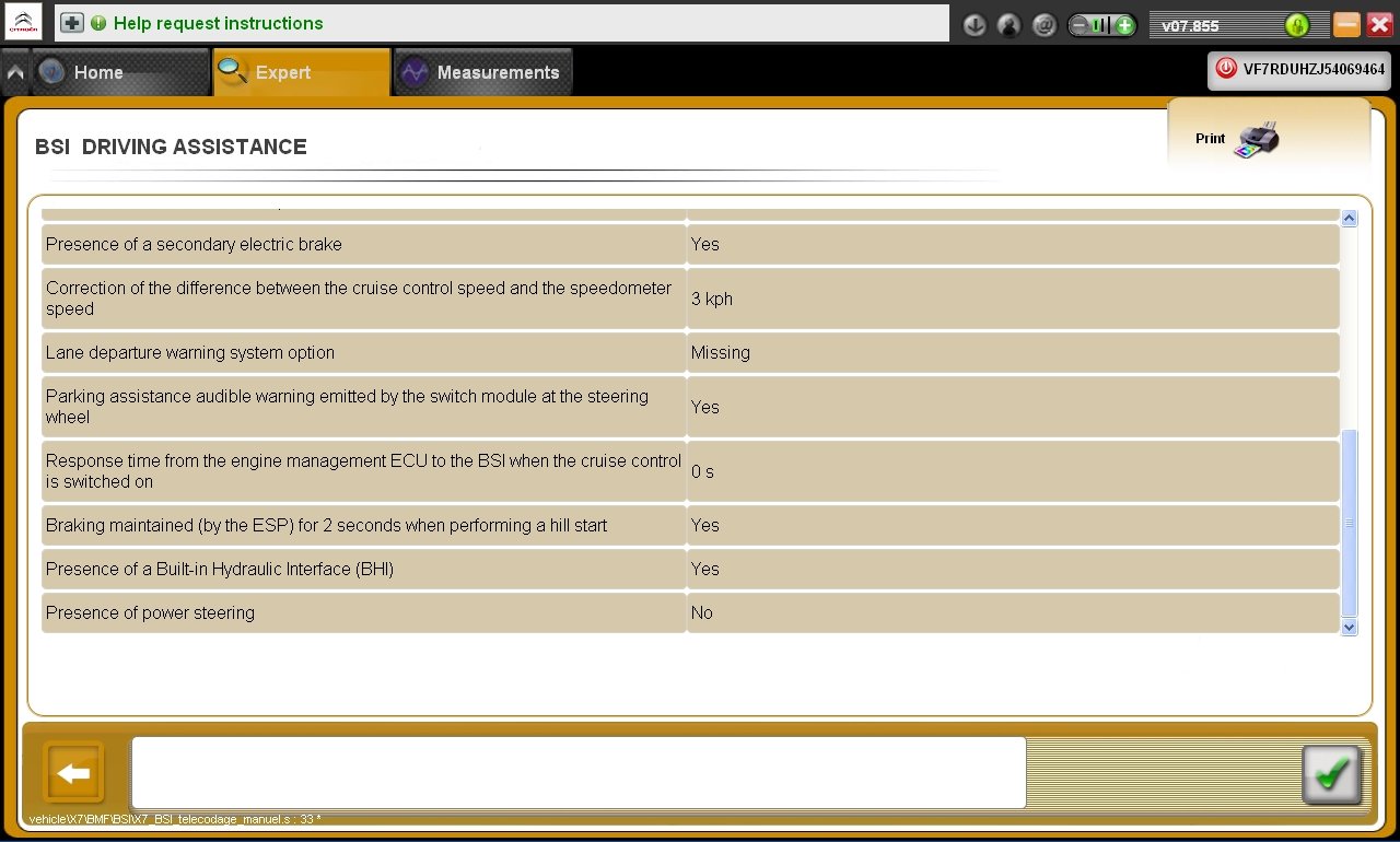

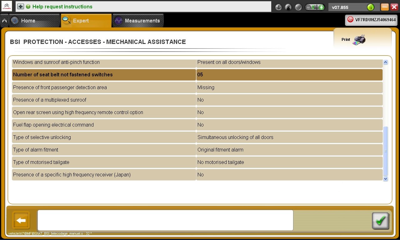

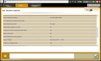

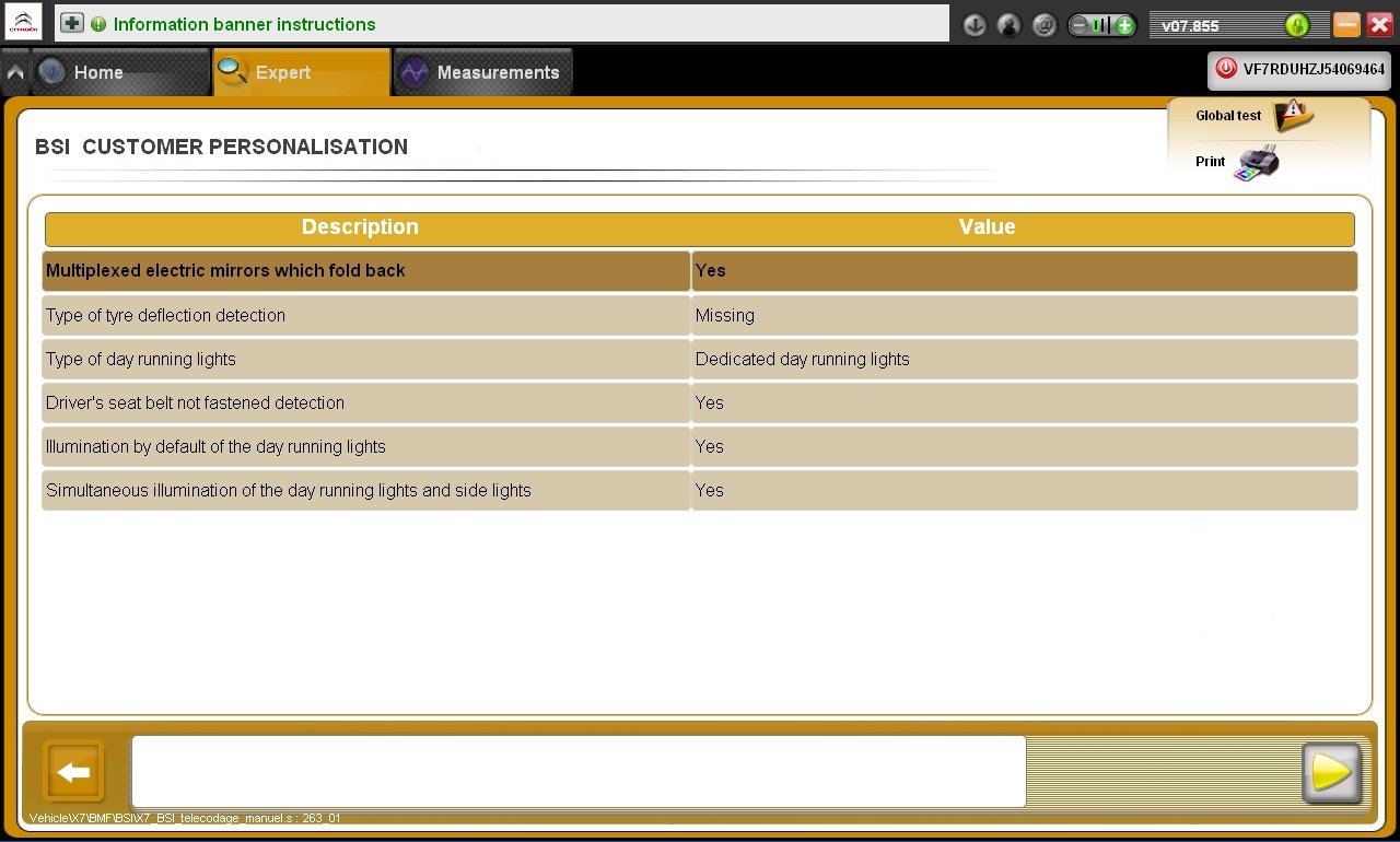

These are the pictures under BSI- section.
Mhirvi
Posts: 19

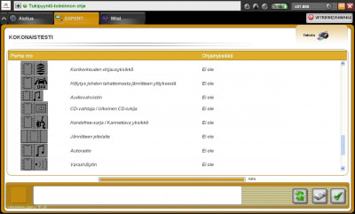

I send them in 3 posts
Mhirvi
Posts: 19
And this is the last set.
