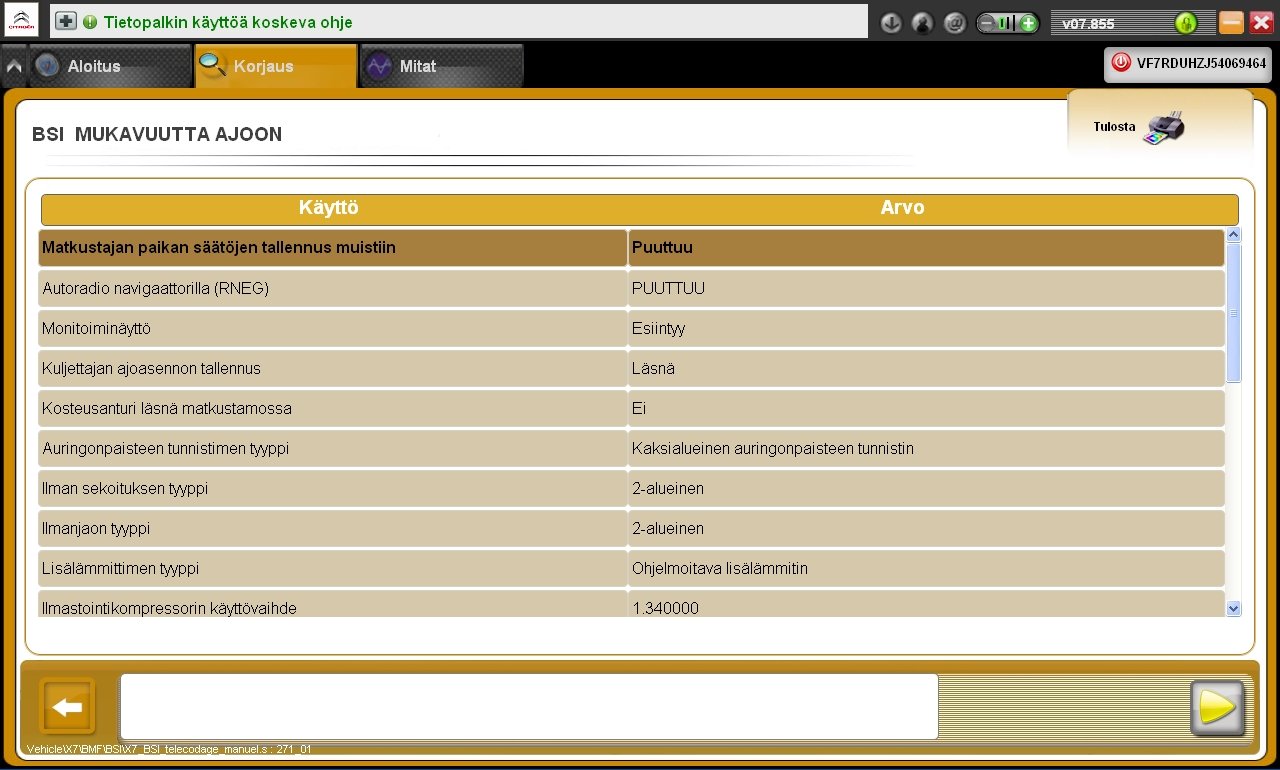

I have C5X7 2008 and bought rneg2/RT6 system from ebay.
Seller coded my vin number in it and make some wiring chages ready, so it was very easy to install.
- everything seems to work.
Now, when I bought a Diagbox and read all errors, I noticed that my car do not recognize mutifunctional screen nor telematicunit(RTx).
Error codes: F023 and F062 appears.
- other codes too, but these seems to be relevant.
I did change some values by Diagbox, so now my parking sound is very annoying :wink:
- After that, I saw it would be best to ask some Help from here.
Because I have read some discussion about similar problems and seems, that first rule is to not make any changes, ask first...
/Markku

There are certain settings in the BSI ECU configuration parameters that must not be changed - because
a) they may not be relevant to the Citroen Marque (as Peugeot vehicles may display info and data on different output displays than Citroen and some Peugeots have retractable screens etc., etc.,). If you change some of these values, you can end up with a non-working car.
b) Some settings are not what you think they are from the description. Example in some areas of configuration, the A/C system is set to absent even though you have A/C - that is because of the specific equipment or display area being configured. So if you change a setting there it can have an impact on equipment not working.
So back to the issue -
a) I need your VIN
b) If you can recall what section you were in and what you changed.
c) If you can't remember, then go back into the BSI options and screen print me out each page of configuration parameters as clear as you can and post them here as images. I can look through them and see what you need to change back. I can't just tell you as there are too many lines and I don't have the time - but if you can provide me with this info, I may be able to spot what you need to do.
Those fault codes relate to the multifuinction screen and to the audio system and are either mis-configurations / communication issues.

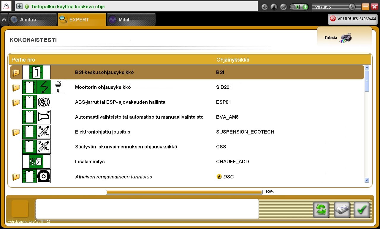

Xantippa is right. I did move the old radio off the system
Marc; I have problem to find the right page for you. Can not find the "BSI option/ Configuration parameters" but I take some photos which I assume to be important
- VIN: VF7**************[VIN obfuscated, can be read by forum staff]
Send the pictures in next message...

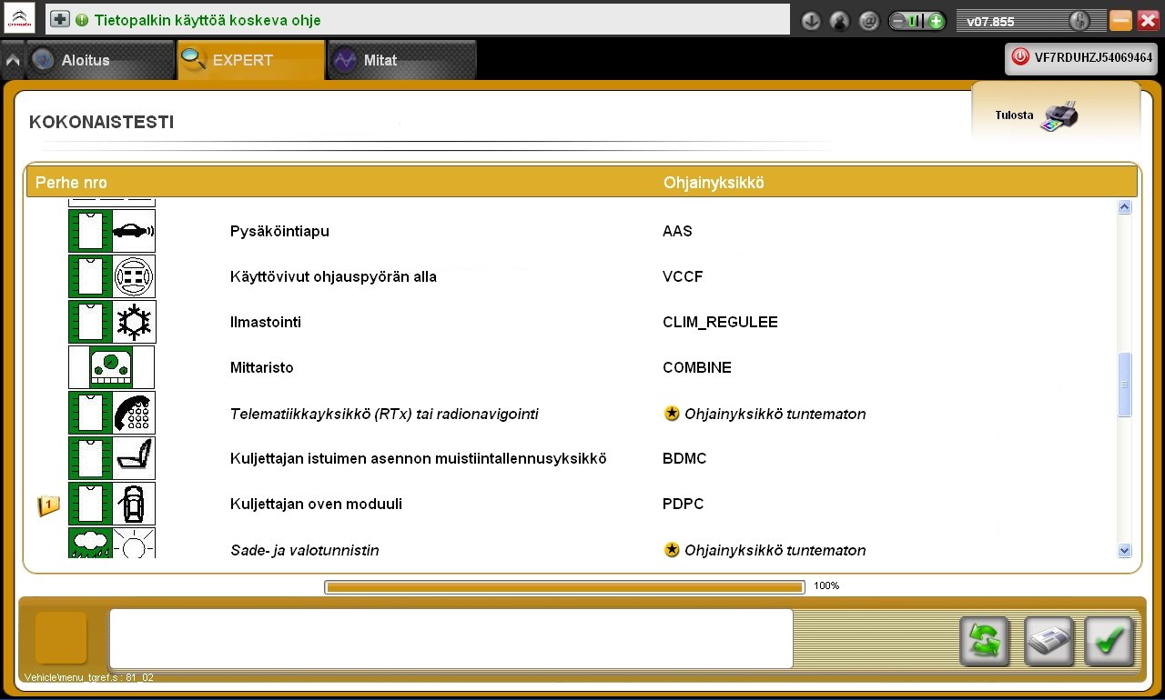

Re: RD4 to eMyWay/RT6 swap problem
Post by Mhirvi »

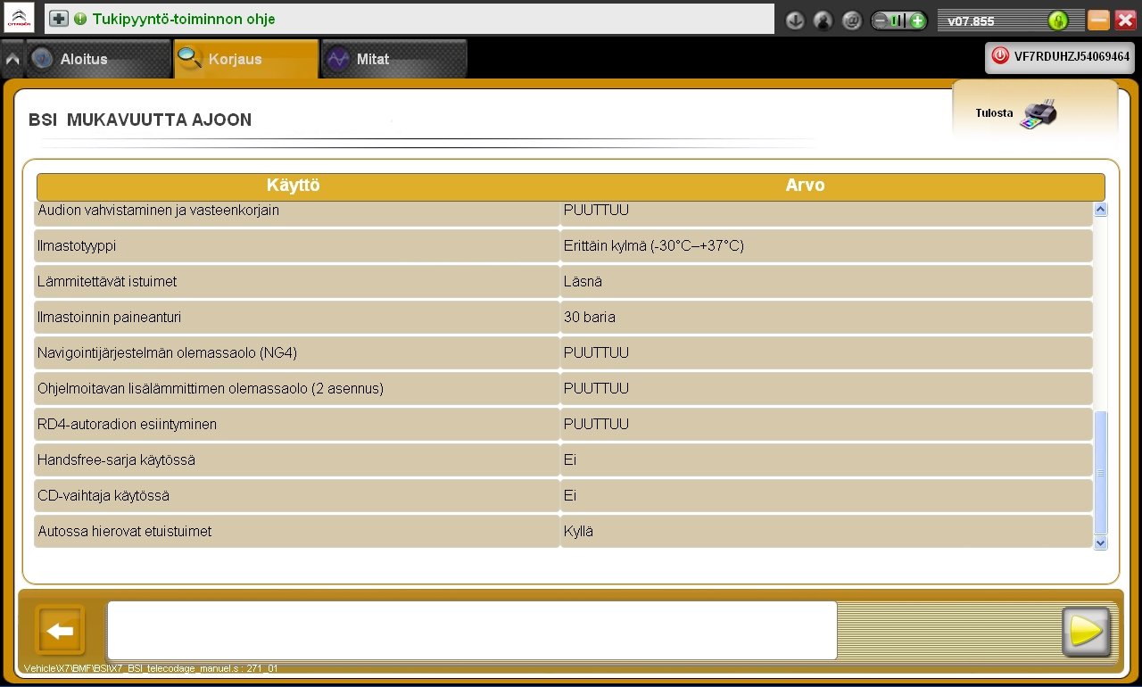

Here is some pictures, hope they help...
Please inform me where to look, if you need more information.
/Markku

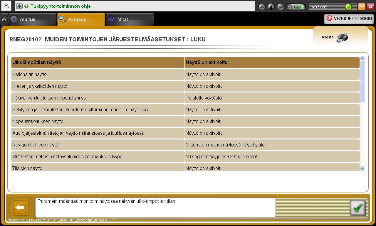

Hi again,
Quick question: Is RNEG2010? correct choice to telematicunit(RTx)

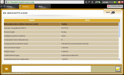

Markku - I'm sorry, but I don't have time to translate all these - it will take far too long. If I'd known these were going to be in Finnish (?) I wouldn't have requested them - sorry.
If you want to try and temporarily change the language you can. If this is actually Finnish - clarify with me first before doing this change, as this is assuming it is Finnish:

Hi Marc,
It is Finnish.
I will change the language and take new pictures.
- I soppouse, I can then find the "configuration parameters" pages better :)
Do you have a picture how it should look like?
/Markku

If you are in the BSI section, just do exactly what you did above - just capture each page so I can see the options and what your current setting is. That's the quickest way for me to try and help. The screen shots that you have done above are perfect - for the BSI - just the wrong language for me :)

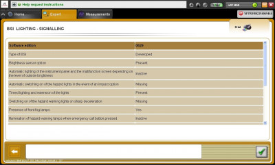

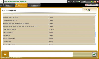

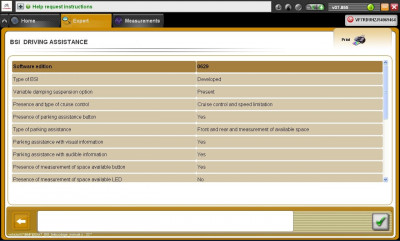

Post by Mhirvi »
Hi,
These are the pictures under BSI- section.
Mhirvi
Posts: 19
Joined: 02 Aug 2020, 14:10
Location: Finland
My Cars: C5X7V62.7
BX16TRS
Post by Mhirvi »
I send them in 3 posts
