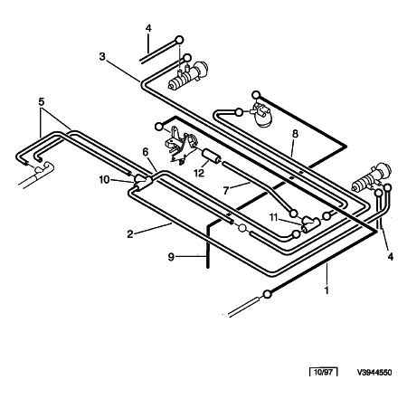

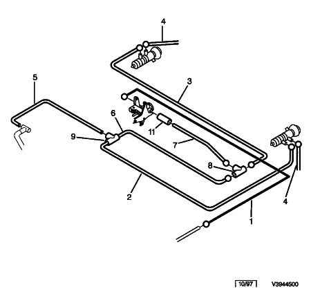

Which part are you after. I assume its the suspension return piping you're referring to?
Does your car have Hydractive suspension? (count the rear spheres - if it has 3 rear spheres as in first diagram below it has hydractive)
If hydractive:
Part 10 is part number 5280 E2; Part 11 is part number 5280 87
If non-hydractive:
Part 8 is part number 5280 E2; Part 9 is 5280 87
In both cases, probably Citroen dealer only, can't imagine any pattern part manufacturer will have attempted a copy. Probably unavailable even from dealer though, so may need fabricate your own.
