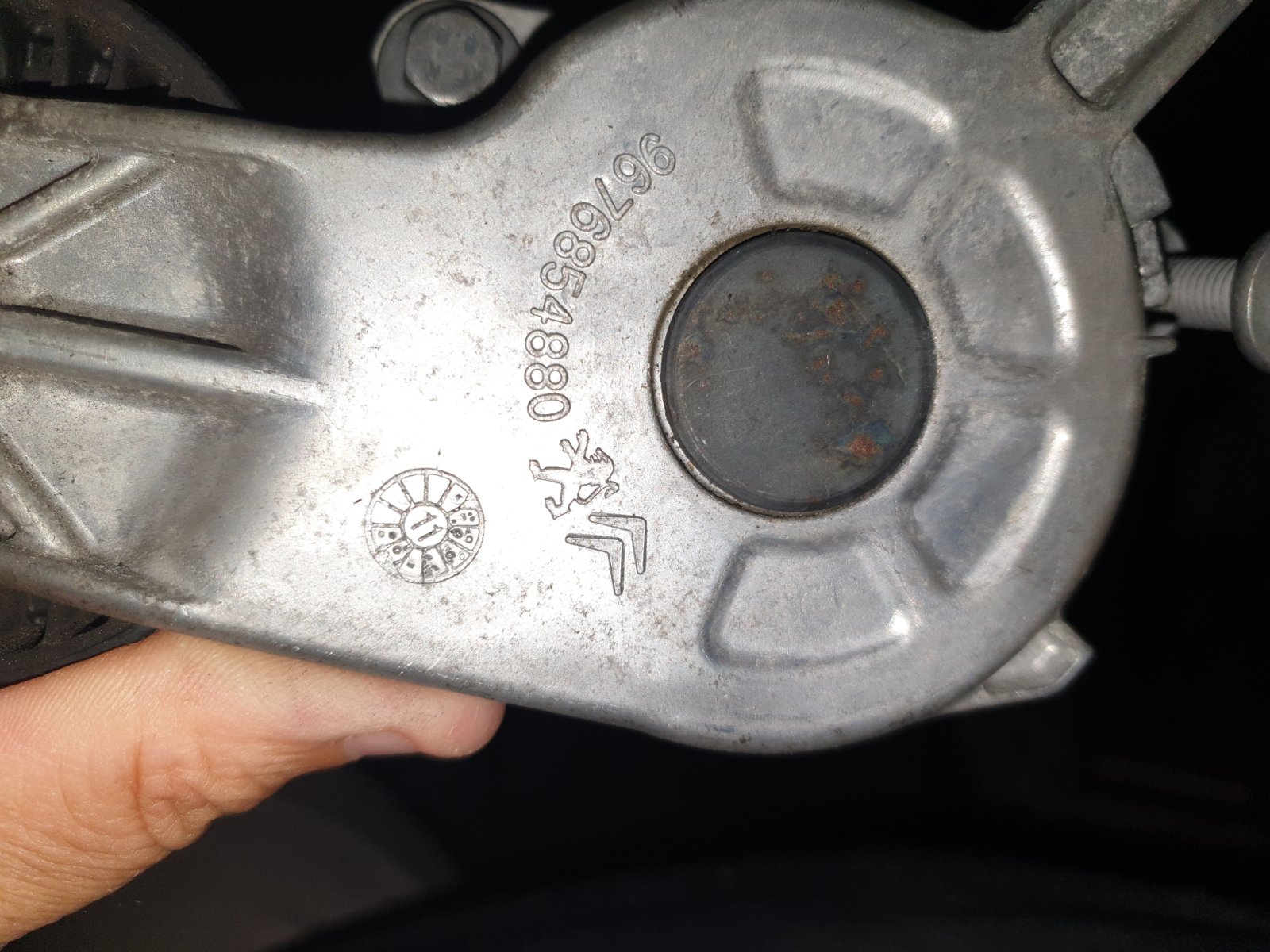

The alternator drive belt tensioner had failed and the belt chewed up.
Have ordered like for like Gates tensioner via ebay but unless I go to Peugeot I'm struggling to find the definitive correct belt and idler pulley.
Weirdly, even the dealer couldn't tell me what tensioner it was from the part number stamped on it despite the fact it had Peugeot and Citroën logos and was OE the part number on there is apparently a Gates number and was not the part number PSA use for ordering!
Bonkers!
Have to get the idler off to get numbers and I'll find it myself but because the belt is wrecked beyond recognition to lift numbers that'll have to be dealer £££££££££ !

It's original tensioner. We've had it from nearly new with less than 10k on the clock. It's now 8 yo and only has 32k!
The tensioner, while having Gates logo also has Peugeot and Citroën logos so it's definitely oem. What i was trying to do with the dealer was get the right one. There are 2 tensioners apparently, a left one and a right one. From what I've found this is the left one. The dealer couldn't work it out from the numbers over the phone.

This is it. Cant see how this is pattern part!
Dealer could not ascertain which one it was from the number on it. They claimed it was an internal number between Gates and PSA not the part number!!

GF1969 wrote: 05 Jul 2020, 22:05 This is it. Cant see how this is pattern part!
Pop your VIN up that will provide the part number used by PSA.

Searching the number on your item brings up this:
https://www.bestpartstore.co.uk/7756643 ... bbed-belt

I managed to go online and cross referenced using the Gates numbers. Got a like for like Gates tensioner including post for £33 which is a fraction of dealer price.
This turned out to be the "left " tensioner. The "right" tensioner was OK but the pulley wheel
had been damaged by the belt getting jammed and melting! The pulley wheel was not a separate item and dealer wanted £102 for the whole unit. So took the wheel off the knackered tensioner and swapped them over. They are identical and interchangeable.
The belt I did buy from the dealer because mine was shredded and I couldn't lift any numbers off it. I just went for the genuine part simply for speed as I didn't want to mess around returning incorrect belts etc. Even that was an eye watering £52 but I now have the correct details for future reference.
