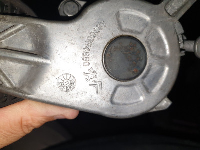

Re: Next Job on the 3008!
It's original tensioner. We've had it from nearly new with less than 10k on the clock. It's now 8 yo and only has 32k!
The tensioner, while having Gates logo also has Peugeot and Citroën logos so it's definitely oem. What i was trying to do with the dealer was get the right one. There are 2 tensioners apparently, a left one and a right one. From what I've found this is the left one. The dealer couldn't work it out from the numbers over the phone.
This is it. Cant see how this is pattern part!
Dealer could not ascertain which one it was from the number on it. They claimed it was an internal number between Gates and PSA not the part number!!

Pop your VIN up that will provide the part number used by PSA.
- Posts: 7207
- Location: GL15***
- My Cars: 2006 C5 2.0 Litre HDI VTR Automatic Estate.(now sold on)
Currently Renault Zoe 2014 ZE - x 2511
Searching the number on your item brings up this:
https://www.bestpartstore.co.uk/7756643 ... bbed-belt
Thanks for all the tips.
I managed to go online and cross referenced using the Gates numbers. Got a like for like Gates tensioner including post for £33 which is a fraction of dealer price.
This turned out to be the "left " tensioner. The "right" tensioner was OK but the pulley wheel
had been damaged by the belt getting jammed and melting! The pulley wheel was not a separate item and dealer wanted £102 for the whole unit. So took the wheel off the knackered tensioner and swapped them over. They are identical and interchangeable.
The belt I did buy from the dealer because mine was shredded and I couldn't lift any numbers off it. I just went for the genuine part simply for speed as I didn't want to mess around returning incorrect belts etc. Even that was an eye watering £52 but I now have the correct details for future reference.
The car is now 8 years old but with only 32800 miles on it we're not in a rush to get rid yet and after 7 years in our ownership we're not bored with it. It's been good to us thus far. This is the first failure we've had on it to date. Having the part numbers should save us in the future.
This was an easy fix. About 30 minutes. But very fiddly. Had to utilise the slender fingers of my son as my sausage, rheumatic fingers struggled a bit!
