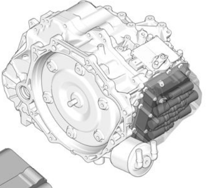

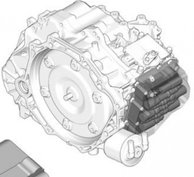

As for the gearbox - what exactly are you after? The complete box, the Hydraulic Block, Converter Casing?
This is the Hydraulic Block: Also let me know if you require current prices for any of these once you've confirmed gearbox part.

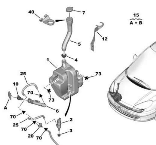

And sorry, it wasn’t the window washer reservoir I wanted but the pump for the headlamp washers that plugs into the reservoir.

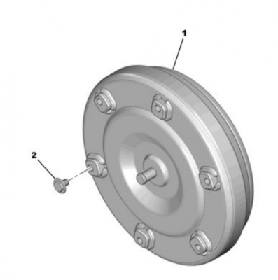

| The Pump (2) is 643477 £82.16 | AGB Converter (Marking 70A120) Part: 2001E7 £682.97 Bolt (M10X125-15,5 LG 20) (2) Part: 200826 ££4.44 |

Hi Julian, yes identical part for the 807 with 2.2 175 engine.jml wrote: 30 Jun 2020, 17:06 Sorry Marc, one other question if I may ?
Can you tell if the torque converter will be the same as one fitted into a 2009 Peugeot 807 with the same Aisin 6spd autobox and 173hp engine ? Unfortunately I don’t have theVIN of the 807.
