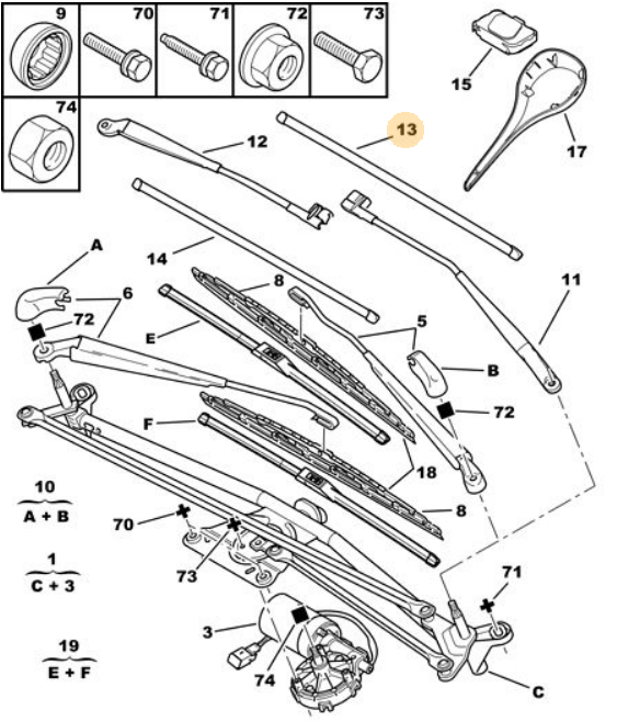

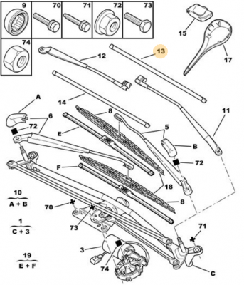

So you have a choice, depending on what you want.
The spring type are item (8)
If you have the arms for the flat blades you have the choice of a twin set E & F (19) or individuals (13) & (14) - but left and right are the same size on all these.
Let me know which ones you want and I can let you know parts numbers and prices.

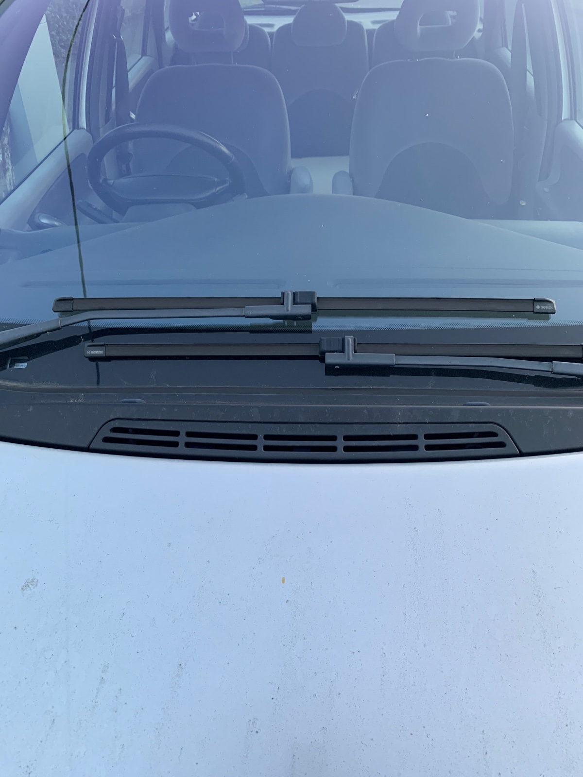

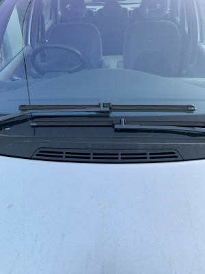

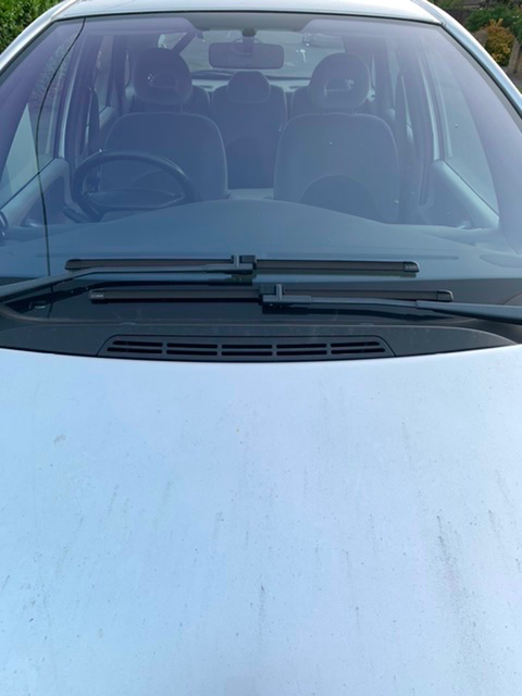

Re: Spain or Sweden? Rear wiper blade.
Reason: Corrected Image Rotation
- x 6954
So it looks like you already have the wiper arms for the flat blades, so 1642335180 is the part number for items (13) & (14).
I think from the looks of it that E & F have fittings for the hook type spring wiper arms, so may not be correct for your wiper arms.
