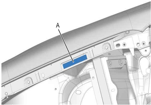

For a MK I or II Berlingo the VIN is also stamped on the front wing inner panel as shown:

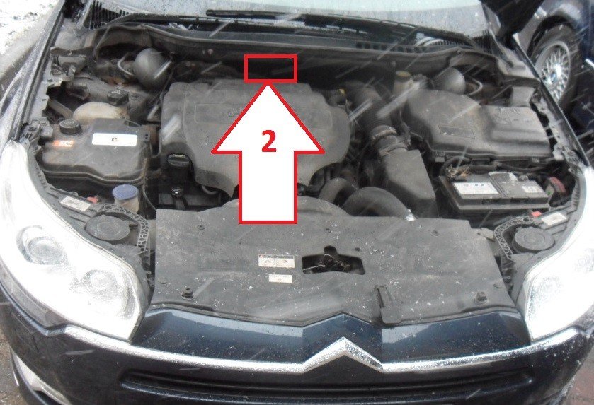

Under the screen, on the right wing/chassis leg and as below. If it is not on the bulkhead as well then there is something VERY smelly about the car.
x 6957
