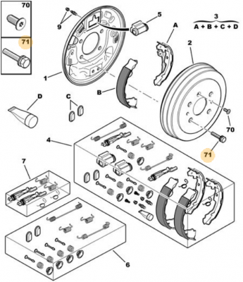

I assume this is for your C1... it just states to use a T30 Torx spanner to remove the screw, then slacken the parking brake before removing the drum.
When refitting, torque the screw to: 0.5 da.Nm, and the wheel bolts to 10 da.Nm

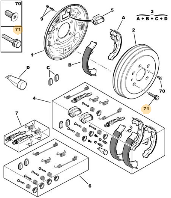

Re: Rear Brake Drum
Thats the one Marc and thanks.
There are two threaded holes on the drum where a bolt can be inserted too wind off the drums. Its those two im looking for.
One can be seen in your picture above. Just above your arrow, the other one is opposite that.

There are no dimensions / pitch listed for either screw Garry, and nothing mentioned about that for removing them in official notes, apart from what I mentioned in my last post.

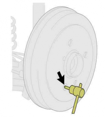

But it's the "In the event of problems removing a drum, insert a drift into the
hole " a" and push the handbrake lever to the side in order to remove the brake linings" that defeats me. Which side?
There was a similar comment in the manual I have, but I can't see anything to push, even when I turn the drum bit by bit from the 4 o'clock to 8 o'clock position and peer through the hole. Just the spine of the brake shoe ...
Obviously missing something
Ciao, Capn K

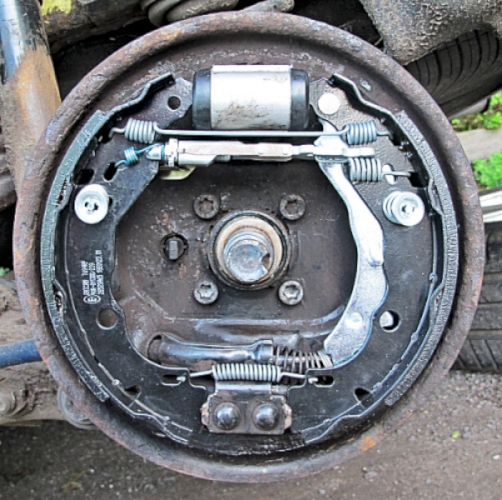

There's nothing else in the procedure, but looking at the handbrake adjustment, maybe this will help you see where the handbrake cable goes into the drum...
Click Image to Zoom
Not great pictures I know.
Click Image to Zoom

I don't know if it helps, but I saw this slightly more verbose description:captainkephart wrote: 24 Aug 2021, 18:57
If difficulty is experienced, due to the shoes wearing grooves in the drum, insert a screwdriver through one of the wheel bolt holes and depress the handbrake lever on the rear brake shoe so that it slides back behind the shoe. This will retract the shoes and allow the hub/drum to be removed.

I think I understand what they mean. If you look at this photo which I borrowed...
The shiny handbrake lever which sits behind the brake shoe which is to the right of the photo has a boss that rests against the brake shoe when the handbrake is released.
If the shiny lever is pushed back (through the wheel bolt hole) the boss will slide behind the brake shoe, releasing the handbrake, allowing the shoes to retract a little more than usual and the drum to be pulled off.

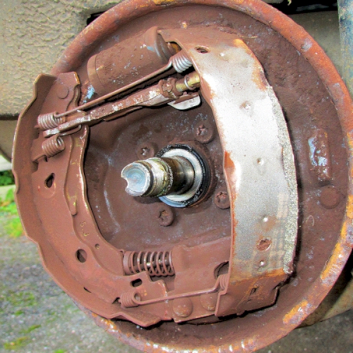

This show it from a different angle/;
