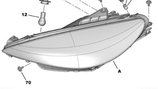

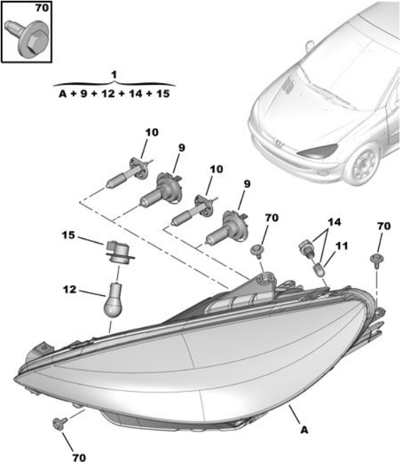

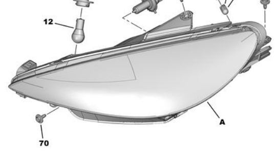

No, they are not the same Pete - they mak LOOK the same but they aren't.
| MK 1 CC Single Optics | MK I Single Optic | MK II Single Optics (but there are 2 versions of lamp depending on build date. |

Ok, so that's a December 2003 Build Cabriolet, with Double Optic Headlamp Unit:
Part Nos:
6204T0 (left)
6205T0 (right)
Part Nos:
6204T0 (left)
6205T0 (right)
