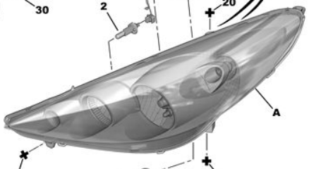

On both the first and second generation 206s, there are 2 versions of headlamps - one with single and one with double optic lamps Pete. This applies to each generation of 206.

Can't help with the reg now Pete - GDPR requirements - so will need the VIN.
No, they are not the same Pete - they mak LOOK the same but they aren't.
| MK 1 CC Single Optics | MK I Single Optic | MK II Single Optics (but there are 2 versions of lamp depending on build date. |

The VIN is better as it will actually tell me what version of lamps it has and I can get the RPO from that too if needed.

Ok, so that's a December 2003 Build Cabriolet, with Double Optic Headlamp Unit:
Part Nos:
6204T0 (left)
6205T0 (right)
Part Nos:
6204T0 (left)
6205T0 (right)

I think it's this as it states H7/H7 and the others state H4
https://www.piecesauto24.com/van-wezel/1291065
Not a bad price new.
