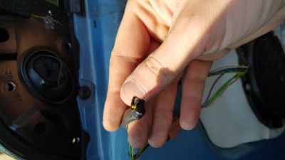

Well I tried to Change the sensor this morning, but it's all been absolutely butchered, wires cut everywhere, which would explain why the electric mirror heating and folding doesn't work also. I've sourced a new mirror on ebay with all the connections and plugs (9 wires) for about £50 which is pretty good I think. Just curious as to whether anyone knows of the mirror caps can be changed as my partners wing mirrors are colour coded
Cheers in advance for any replies!
- x 6955
Re: C3 external temp
That does look like a dog's breakfast.

Update.. New (used) mirror arrived, all fitted and everything working, external temp, electric mirrors and power folding working. I had a look at the other wing mirror as motor was running but not power folding, discovered that the wing mirror was screwed into place as mechanism had snapped off
