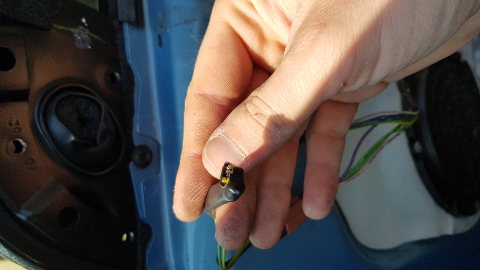

Well I tried to Change the sensor this morning, but it's all been absolutely butchered, wires cut everywhere, which would explain why the electric mirror heating and folding doesn't work also. I've sourced a new mirror on ebay with all the connections and plugs (9 wires) for about £50 which is pretty good I think. Just curious as to whether anyone knows of the mirror caps can be changed as my partners wing mirrors are colour coded

That does look like a dog's breakfast.
The C3 mirror tops can be removed and replaced. There are clips on the short edges of the cap than can probably be carefully removed with a blunt trim removal tool.

Re: C3 external temp
Cheers for that! Yes even the wires aren't connected to the glass behind, even though it wouldn't have made a difference haha! At least I know how it all comes apart now so should be straight forward to whip out and change next weekend lol
