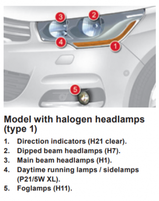

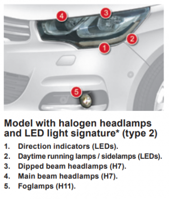

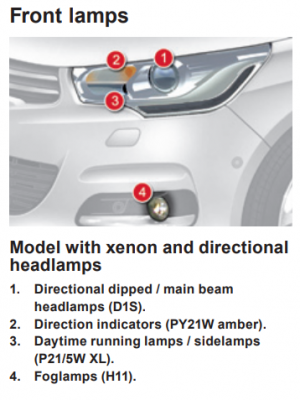

These are some of the reasons why you wont get a clear answer.
For this C4 there are 3 types of headlight units, one in particular for the Coupe.
A Xenon directional headlamp with standard halogen bulbs for indicators and DRLs.
A Halogen headlamp standard DRL and DRL / Sidelamps
A Halogen headlamp with LED indicator and LED DRL lamps.
The standard halogens lamps have specific harnesses in place for those lights.
Directional Xenons require a different harness and power supplies, ECU for levelling, body height sensors and configuration, plus wash wipe headlamp system (although the halogen versions may also have this fitted). It is such a lot of work and expense that it's the reason why it is rarely done.
They each have a different wiring harness and the BSI will need to be configured correctly too.
It's usually such a lot of work / expense it is rarely done.

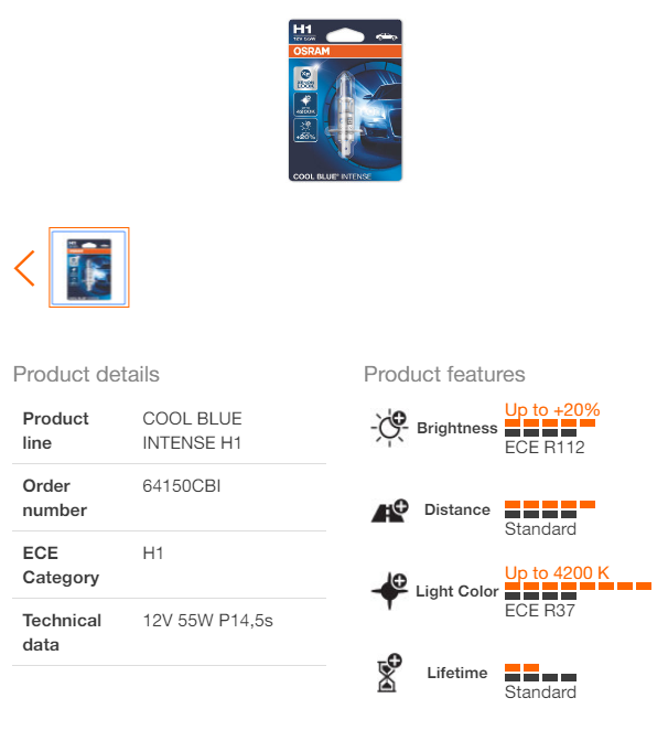

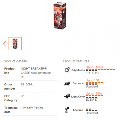

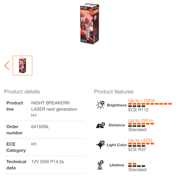

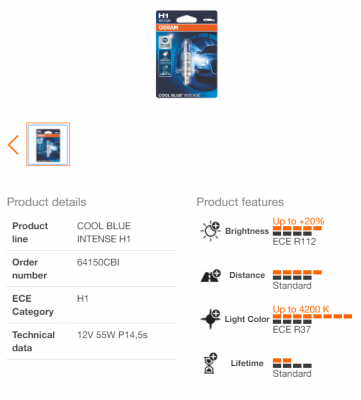

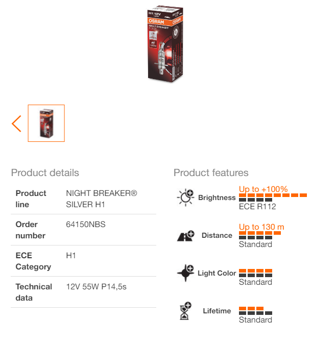

I have to agree there. If we look at Osram's bulbs in my table below, you'll see that the brighter they are the less life they have compared to a standard halogen. The intense blue seem worse for the gain.
The exception to this of course are the true Xenon discharge bulbs, which seem to last forever - and so they should given the price! I think I replaced my D1S bulbs about 5 years ago for the Xenarc Unlimited and they are still as good as day 1.
| Nightbreaker Silver +100% brighter = 75% of the life of their Standard Bulb. | Nightbreaker Laser +150% brighter = 50% of the life of their Standard Bulb. | Cool Blue Intense +20% brighter = 50% of the life of their Standard Bulb. |

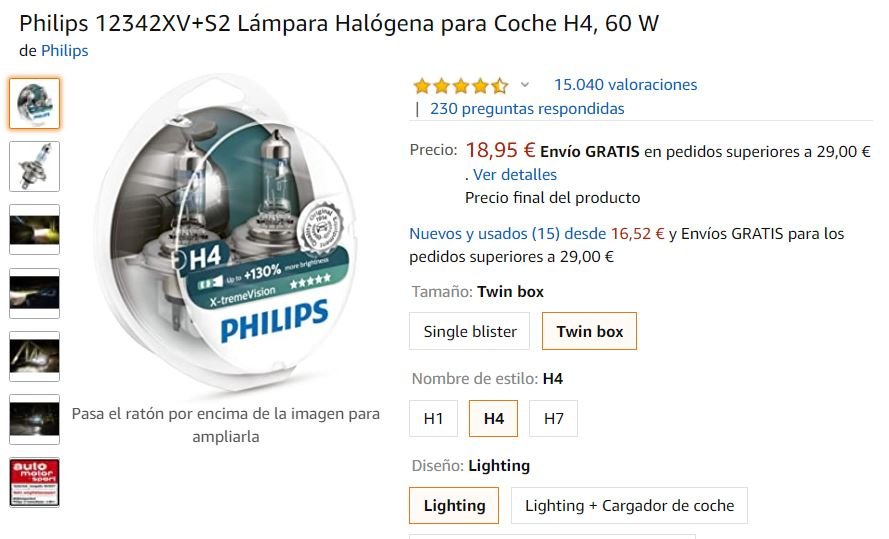

Maybe I've been lucky, but all the Nightbreaker and X-treme bulbs I've used (on two vehicles) have just soldiered on and on. Replaced some pairs just because of old-age (like 4-5 years old).
There are many fakes about, so I've been careful always to buy in pukka packs (of 2), with the genuine hologram. Usually avoid anything conspicuously cheap.
These were the last ones I bought - Amazon.es, Jan.2018 - and fitted immediately. Still aok.
