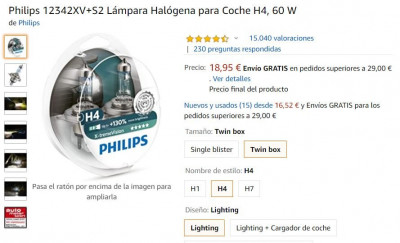

Maybe I've been lucky, but all the Nightbreaker and X-treme bulbs I've used (on two vehicles) have just soldiered on and on. Replaced some pairs just because of old-age (like 4-5 years old).
There are many fakes about, so I've been careful always to buy in pukka packs (of 2), with the genuine hologram. Usually avoid anything conspicuously cheap.
These were the last ones I bought - Amazon.es, Jan.2018 - and fitted immediately. Still aok.
