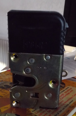

Not sure if this will help, it's a C5 lock but may be the same. The levers arrowed purple are the lock levers, when they're down as in the picture the door's locked.
The levers arrowed orange are the latch levers.
If you can get a hooked wire down in there and pull the purple one up it should unlock the door.

Thanks Gibbo I will try that in the morning. Just need an old wire coat hanger!

If its stuck in a deadlocked state a wire coat hanger will do nothing.
