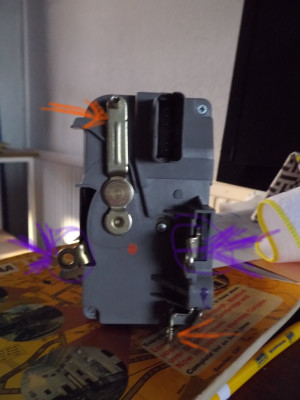

- x 2941
Re: Xsara driver's door locked unable to open
Not sure if this will help, it's a C5 lock but may be the same. The levers arrowed purple are the lock levers, when they're down as in the picture the door's locked.
The levers arrowed orange are the latch levers.
If you can get a hooked wire down in there and pull the purple one up it should unlock the door.
