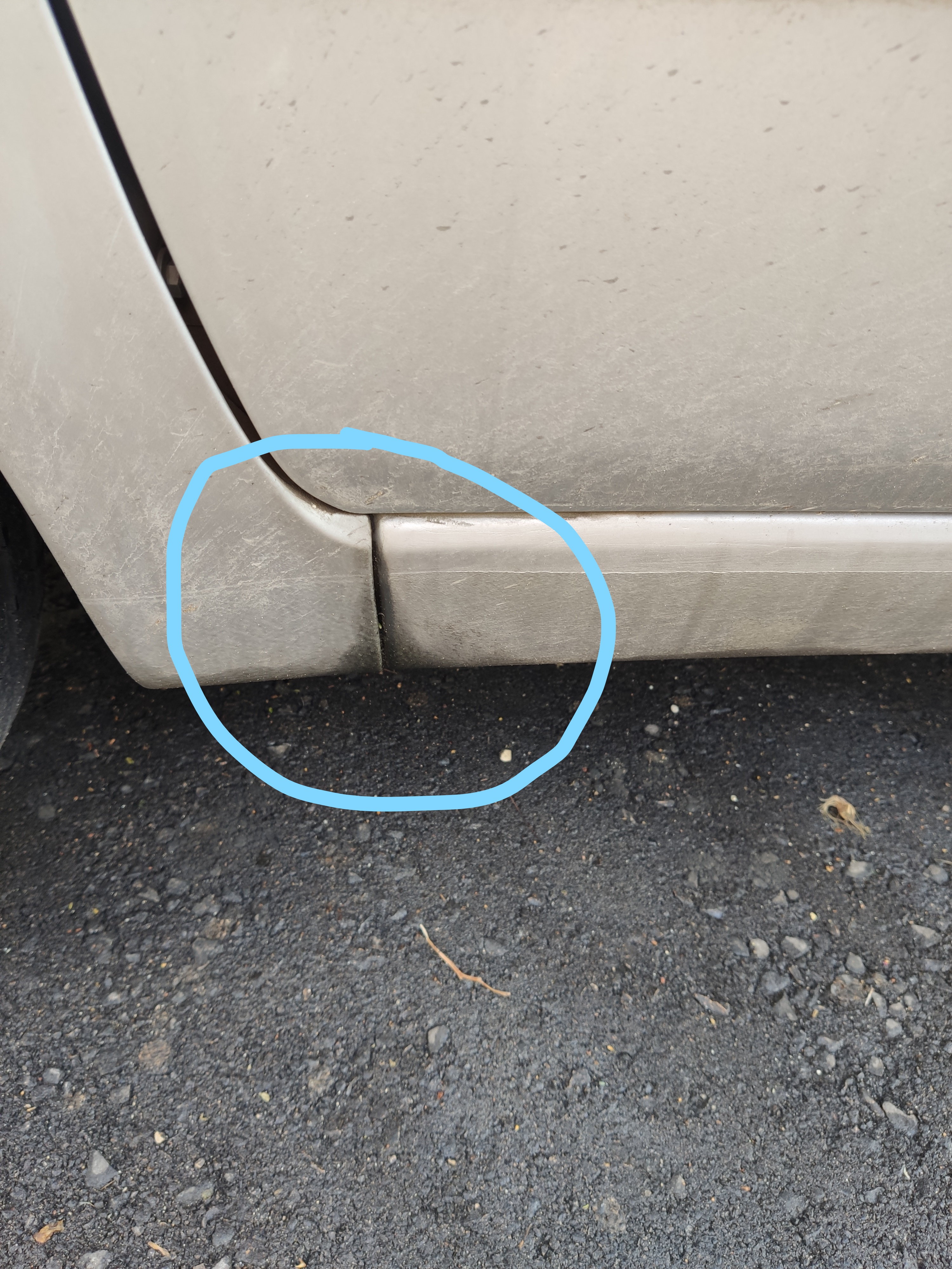

Hi
There is an LHM between the front left door and left fender (LHD car ). The top struts ( left and right ) leaked from the o-ring. I replaced both struts and the suspension cylinders ( left and right ) to new ones. I cleaned the LHM in the thought that it comes from the leaked struts but leak is still there. Any one can suggest the source for that leak ?

Re: Xantia MK II - LHM under rear carpet
Yes I checked - it was a bit wet a month ago - I cleaned it with a wiper and since then it is dry but I suspect it. If it is the doser leaking how it finds it way to the spot I marked in the picture ?

Ok
Is it the same source ? If you remover the wing liner you will/should be able to see the source of that staining......
Try a dry paper wipe and check the bulkhead insulation (by pressing the paper on) for that being soaked....it must be coming from somewhere.
