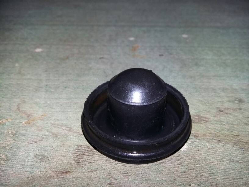

Hi everyone. My brake valve back O ring has failed and slightly leaking. Can I have some advice on replacing the O ring.

if it is leaking into the cab by the pedals you will require
Part Number Description Quantity Price excl. VAT Price incl. VAT Total incl. VAT Selection
5424455 CNTRL-UNIT RING 3.88 GBP 4.66 GBP 4.66 GBP
95640067 BRAKE PROTECTOR 7.18 GBP 8.62 GBP 8.62 GBP
these price's are copied from a post i made some time ago, so there might be a slight difference now

The leaking seal is not the one attached in picture. Its the O ring that is leaking.citronut wrote:if it is leaking into the cab by the pedals you will require

The seal in your photograph is the seal citronut has said. I know because I just replaced mine and that's what it looks like.
The doseur comes out fairly easily. 4 x 8mm metal LHM pipes, 2 x rubber LHM pipes. 2 x 45 torx screws hold the doseur in. On my car there is another LHM unit clamped onto the bottom of the doseur, held on by a small screw at the top.

The seal in the previously attached picture is fine. But the other side O ring is one thats leaking.Jaf wrote:The seal in your photograph is the seal citronut has said. I know because I just replaced mine and that's what it looks like.

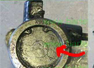

So it is part number 9 in above diagram which is leaking.
--- 09 _____ 95 638 813 _____ BRAKE O-RING _____ TOR 42 T1,6
