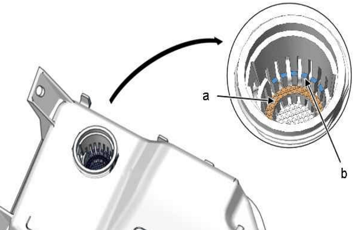

Make sure it has not been overfilled.
It must be only be filled between the 'A' & 'B' marks whilst the car is on the lowest suspension setting.
And as Steve says, if it has been in the hands of an incompetent garage, they may not have been aware to raise the car up to highest suspension first and remove the LDS cap if it will be raised where the wheels will be left hanging.
