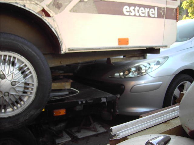

I brought a 307cc back in November which I knew needed some work. I parked it in my drive and finally got time to work on it yesterday but the battery is dead so I can't get into it! Remote doesn't work so I unlocked the door manually but can't open it. Problem is on this model, once the door is unlocked, the window drops about 5mm when the door handle is touched. When the door is closed the window goes up 5mm into a channel in the roof to stop leaks. With a dead battery the window can't drop so is stopping the door from opening. I don't want to force it or try and spring it out in case I damage something or break the window. The only way I can think of getting in is to get the bonnet open and change the battery but how without damaging it? The only other option is break the window but getting a used replacement will be difficult and a new one very expensive. Has anybody had this problem or can anybody suggest a solution?

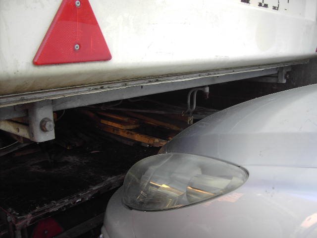

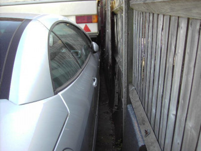

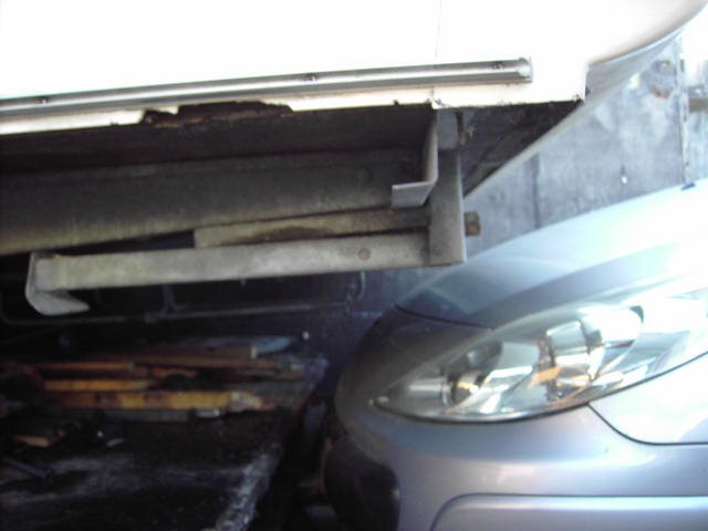

Unfortunately the problem is the car is parked close to the fence and close to my trailer, caravan is parked on the trailer and front of cc is parked under the caravan (see photos) so I can only jack it up a few inches. I tried to pull it back with a hand winch attached to the towbar and the towbar of my other car, but only succeeded in pulling my car up onto the footpath.

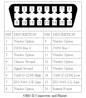

That is the worst situation possible, you need to get to any wire that has constant battery power, if you have a key for the door you can open the door enough to connect power to the OBD connector pin 16 that is constant battery power, you can connect a battery charger to it or another battery that will allow you to use the central lock and put it in neutral to push it back.

Yes this is the worst situation possible, that's why I posted the photos as I didn't think anyone would believe me. Can't get to the OBD socket as it's behind the gear lever, under the ash tray but this gave me an idea. Car is fitted with a towbar and twin 7 pin sockets. Pin 3 on the black socket is earth and pin 4 on the grey socket is permanent live for the caravan interior lights. I made up a lead using pins from a broken socket and connected it to my jump pack. I left it a few minutes for the electronics to settle then tried the remote, success, I'm in! I managed to open the bonnet enough to connect my Optimate 111, with a little help from above mentioned midgets! Problem is there wasn't enough power to raise the window and lock the door, (start pack probably drained by flat battery) and car went into economy mode. I made up another lead to connect the tow sockets to my car battery and started the engine. This tricked the car into thinking the engine was running and after a few minutes it came out of economy mode the window lifted and I locked the car. Optimate 111 usually take several days to fully charge a flat battery so I'll need to be patient, hope I haven't killed the battery by running and leaving it flat!
