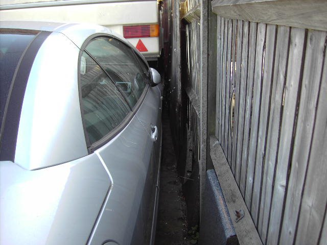

Thanks for the replies, think I'll try pulling the door open as a last resort, knowing my luck glass will break! Can't get in even if I get the door open. I think my best option is the similar suggestions from doctle and goceKU. I also thought I may be able to hook the catch or cable with a wire through the grille. This worked on the MK1 but can't even see the catch on the MK2 cc, even using a mirror.
Unfortunately the problem is the car is parked close to the fence and close to my trailer, caravan is parked on the trailer and front of cc is parked under the caravan (see photos) so I can only jack it up a few inches. I tried to pull it back with a hand winch attached to the towbar and the towbar of my other car, but only succeeded in pulling my car up onto the footpath.
Tried to borrow some skates to put under the rear wheels, everybody borrows my tools and equipment but a different story when I want to borrow something. Too expensive to buy when I'll probably never use them again so I'm making some. If they work I'll use one of the above methods to get in, and will keep you informed of progress, meantime any further suggestions welcome.
When I get in I intend to fit a charging lead to the battery and hide it under the scuttle, lead is for motorbikes so is waterproof. I will also fit another cable to the bonnet release catch and hide it under the car where I can reach it easily if this occurs again.

Unfortunately no midgets small enough to squeeze in, even my neighbor's 6 & 8 year old boys can't squeeze in. Not in gear but handbrake firmly on, surface rust on discs doesn't help. I have a trolley jack and a cross beam I can attach to it, problem is the jack wheels caught in the ruts and nearly tipped it off the jack, gave up on that idea for fear of doing some damage.
Yes this is the worst situation possible, that's why I posted the photos as I didn't think anyone would believe me. Can't get to the OBD socket as it's behind the gear lever, under the ash tray but this gave me an idea. Car is fitted with a towbar and twin 7 pin sockets. Pin 3 on the black socket is earth and pin 4 on the grey socket is permanent live for the caravan interior lights. I made up a lead using pins from a broken socket and connected it to my jump pack. I left it a few minutes for the electronics to settle then tried the remote, success, I'm in! I managed to open the bonnet enough to connect my Optimate 111, with a little help from above mentioned midgets! Problem is there wasn't enough power to raise the window and lock the door, (start pack probably drained by flat battery) and car went into economy mode. I made up another lead to connect the tow sockets to my car battery and started the engine. This tricked the car into thinking the engine was running and after a few minutes it came out of economy mode the window lifted and I locked the car. Optimate 111 usually take several days to fully charge a flat battery so I'll need to be patient, hope I haven't killed the battery by running and leaving it flat!

Tow hitch on a convertible
i'm glad you got access. I had to tow my neighbor this winter he managed to get himself trapped in his golf in a very similar situation, i wrapped a strap around one back wheel and pulled him back with both rear wheels locked ( electric parking brake) wasn't too hard.
