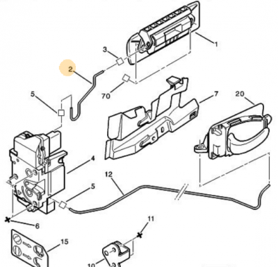

Does the vehicle lock ok? If so, the electronic module will likely be alright. We really also need a VIN to determine the exact system you have as there are differences in the locking mechanisms depending on build date. But generally speaking, some models have a cable link from the internal door release handle to the door lock module. As this is operating when you open the door from the inside, it is likely that it is the external door handle mechanism that has possibly become detached and / or damaged.
Once we have your VIN, I can put up a diagram to show the components.

There's only one design on Xsara Picassos, and it's rod operated. Likely that the impact has dislodged the rod or broken the handle. Door card off and it will become apparent; should be able to get parts from a scrapper.

For some reason I was looking at the C4 Picasso - which has at least 2 different types.
So it will likely be item (2) - the outer door control rod that may have become detached.

Re: Citroen Picasso Desire door won't open from outside
That's the front, Marc, but the rear is similar....

As you can see, I'm totally on the ball today!
Thanks Richard, I've corrected the image above to show the rear door. Off to batten down the hatches now ready for the storm.
