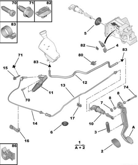

Re: 2011 C3 Picasso 1.4 16v - Hydraulic clutch?
Could someone possibly give me a part number and a price for the clutch slave cylinder please?
Book time for the job to change it please also - is it a gearbox out job or is the cylinder external? I can't look as the car is at the dealer. He's had it 6 days. I'm seriously considering rejecting it as he's not returning my calls or emails either.
Book is about an hour for the Clutch slave Cylinder alone.
Book time is about an hour for Clutch Slave Cylinder alone.
Part number: 2182E1, currently priced at £59.63 inc. from Citroen.
Item (11)
No gearbox out from what I can see - that's only required for the clutch itself.
Item (11)
