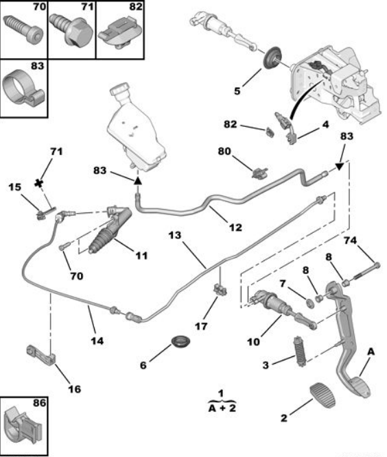

Yes, hydraulic Clutches on these. I have the VIN, so removed your Reg. C3 PICASSO FAMILY SALOON 1.4 VTi 16v 95 Manual gearbox 5.
However, apart from the usual checks there was also a Technical Service Bulletin for these. Specifically, it is where gear changing is difficult / impossible.. Caused by Electrolytic fluid from the battery which can leak / spill onto the hydraulic clutch pipe. So a check is needed to see if the pipe has been holed and if so, replaced.

Could someone possibly give me a part number and a price for the clutch slave cylinder please?
Book time for the job to change it please also - is it a gearbox out job or is the cylinder external? I can't look as the car is at the dealer. He's had it 6 days. I'm seriously considering rejecting it as he's not returning my calls or emails either.
x 6955
Re: 2011 C3 Picasso 1.4 16v - Hydraulic clutch?
Book is about an hour for the Clutch slave Cylinder alone.
x 6955
Book time is about an hour for Clutch Slave Cylinder alone.
Part number: 2182E1, currently priced at £59.63 inc. from Citroen.
Item (11)
No gearbox out from what I can see - that's only required for the clutch itself.
