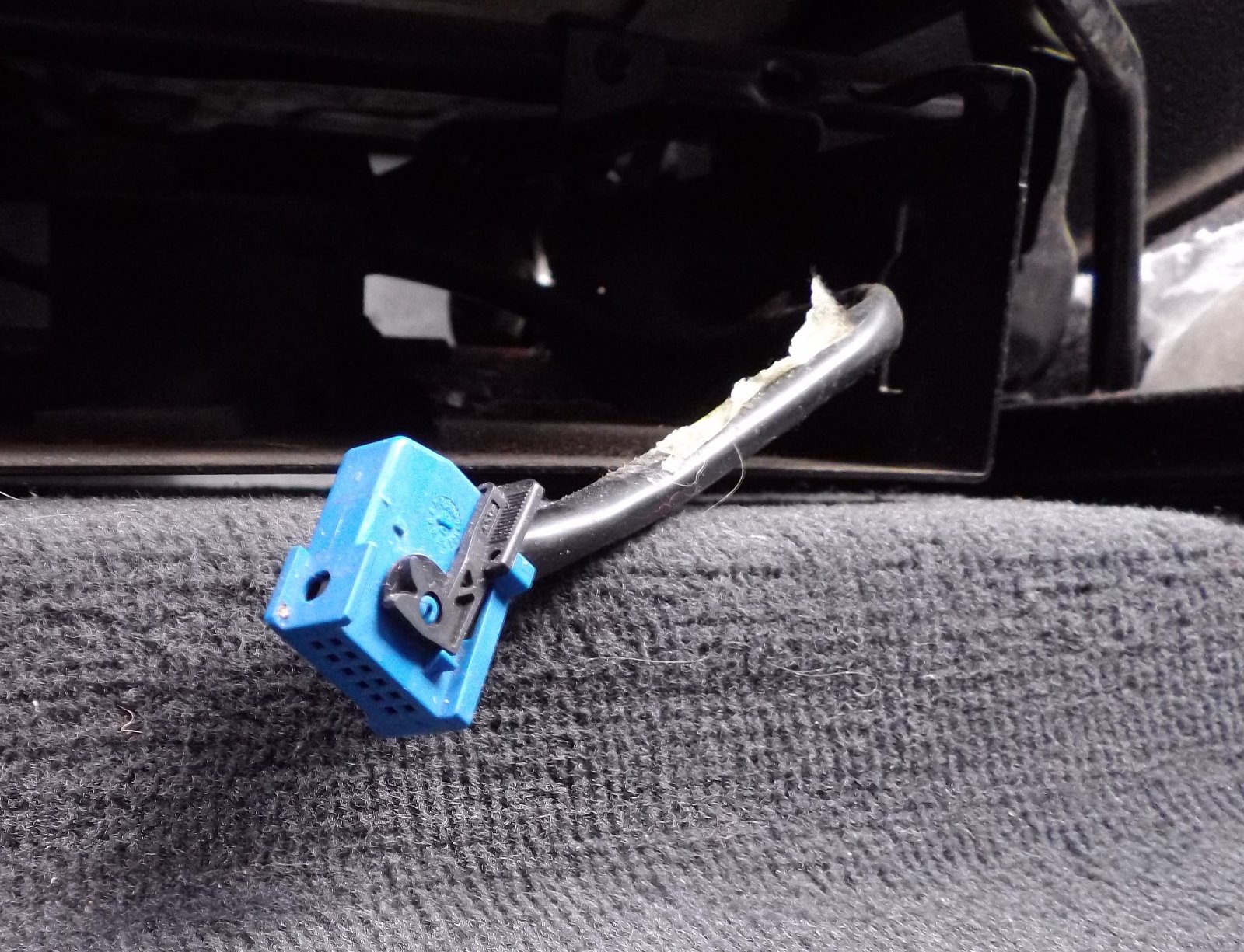

so after doing research it seems it should be prewired for it under the drivers seat, now i have taken a quick look tonight and couldn't see anything apart from the airbag connectors
would it be under something or hidden away?
x 2938
Re: cd changer
This is the connector on my C5.
