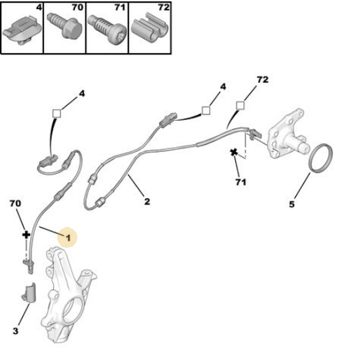

First of all I wouldn't be in too much of a hurry to change the ABS unit - not without evidence of it being faulty!
Did the garage provide you with the diagnostic codes? If not, why not? For all you know it might be a simple speed sensor on one of the wheels. A fault on any one of these will throw an ABS error up. Here's the wheel sensors:
Changing the ABS unit is going to cost you as the braking system has to be drained and bled, not to mention the labour on that - but if it is not the cause, then you've spent money changing it unnecessarily. I would get a second opinion, and get a garage with Peugeot Planet 2000 diagnostic software and ask for the fault codes, then put them up here and we might be able to give you some pointers.
If it is a speed sensor, it will be a lot cheaper to replace. Generally ABS units are robust.
There is also the possibility it is the ABS relay - which is also available separately - but without the codes we are guessing to be honest.

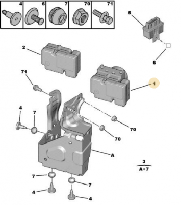

However if you want the part numbers, here they are:
(2) The ABS ECU (if not reusing your own one will need coding and is part: 4542N1
(1) The Hydraulic Block is part: 4541FX
(5) The relay is part: 454935 (12V 20/30Amp)

These are the Peugeot part numbers - but can be used to search for aftermarket ones. It is very important you get the correct one as there are many variants and all look the same.
If the problem is within the hydraulic block (1 on the diagram) then you should be able to use your existing ECU (item 2), and that will save having to programme the replacement unit.
