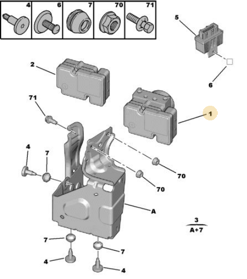

However if you want the part numbers, here they are:
(2) The ABS ECU (if not reusing your own one will need coding and is part: 4542N1
(1) The Hydraulic Block is part: 4541FX
(5) The relay is part: 454935 (12V 20/30Amp)

These are the Peugeot part numbers - but can be used to search for aftermarket ones. It is very important you get the correct one as there are many variants and all look the same.
If the problem is within the hydraulic block (1 on the diagram) then you should be able to use your existing ECU (item 2), and that will save having to programme the replacement unit.
