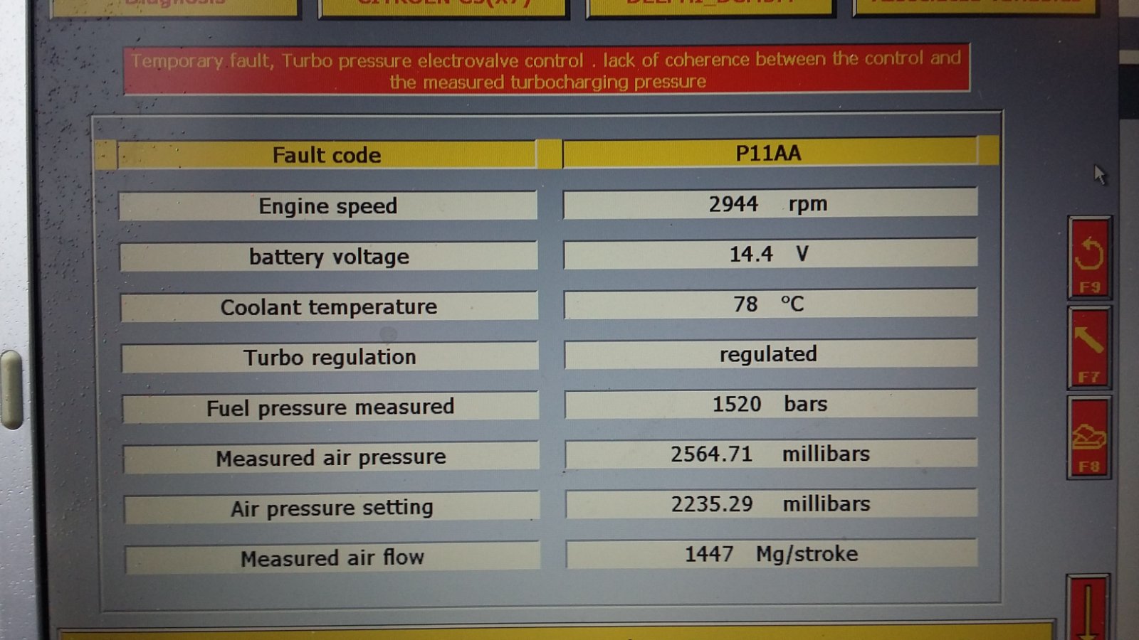

DPs Fault 1 hour before MoT.....
I quote:
Lack of coherence between the control and the measured turbocharging pressure.

Fault P11AA
Turbocharger pressure regulation solenoid valve control: Incoherence between the command and the measured turbocharging pressure. Incoherence between the position of the turbocharger solenoid valve and the measured turbocharging pressure for 3 seconds: With the engine running, the airflow must be below 40 kg/h compared with the theoretical flow for 3 seconds.

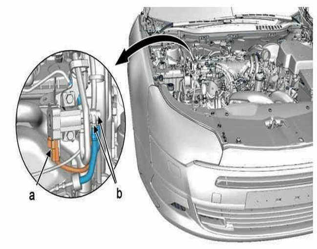

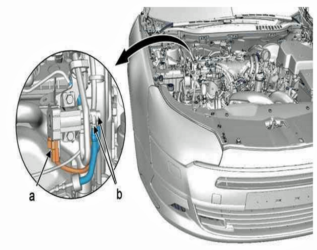

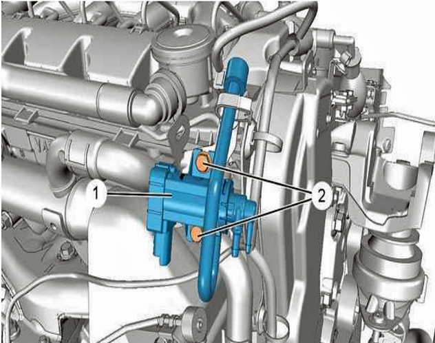

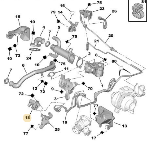

Rear of engine Driver side Alasdair. Guide in case you need it..
Usual - Disconnect Battery
Remove the engine style cover
Click images to Zoom
Refitting
Refit:
| Disconnect the connector (at "a"). CAUTION: On each removal, mark the direction of the vacuum pipes. Uncouple the vacuum pipes (as "b"). | Remove:
Refit:
- The turbocharger solenoid valve (1)
- The bolts (2)
- Couple up the vacuum pipes ( as "b").
- Connect the connector (at "a").
- Refit the engine style cover .
- Posts: 10915
- Joined: 09 Nov 2005, 22:03
- x 1438
Re: DPs Fault 1 hour before MoT.....
I see from the drawings above that (like the turbo control solenoid on the THP engines) the filter is remotely mounted on the tube that loops upwards, and on mine, the rubber cover over the filter had shrunk, restricting the flow and causing over-boost errors, simply removing the rubber cover fixed the issue.

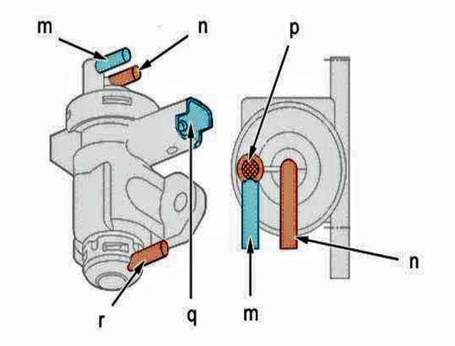

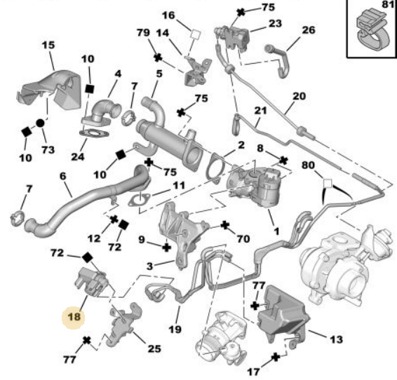

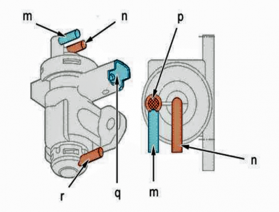

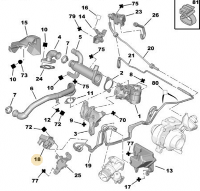

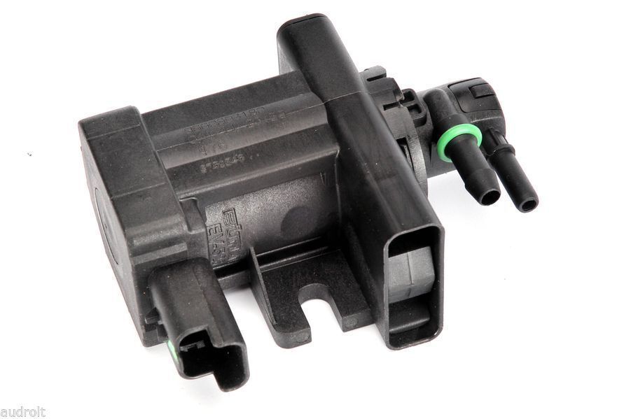

Bear in mind the part you listed above is the EGR solenoid - not the turbo pressure solenoid valve! They have different part numbers...
1618S5 may be the one you want.... part 18
"m" Outlet to boost pressure waste gate (WASTGATE).
"n" Vacuum inlet (via the vacuum pump).
"p" White marking.
"q" Connector.
"r" Atmospheric pressure inlet.
"p" White marking.
"q" Connector.
