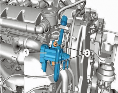

Where is the valve btw ?

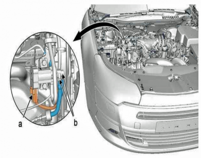

Re: DPs Fault 1 hour before MoT.....
Rear of engine Driver side Alasdair. Guide in case you need it..
Usual - Disconnect Battery
Remove the engine style cover
Click images to Zoom

| Disconnect the connector (at "a"). CAUTION: On each removal, mark the direction of the vacuum pipes. Uncouple the vacuum pipes (as "b"). | Remove:
Refit:
- The turbocharger solenoid valve (1)
- The bolts (2)
- Couple up the vacuum pipes ( as "b").
- Connect the connector (at "a").
- Refit the engine style cover .

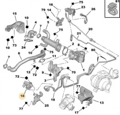

I see from the drawings above that (like the turbo control solenoid on the THP engines) the filter is remotely mounted on the tube that loops upwards, and on mine, the rubber cover over the filter had shrunk, restricting the flow and causing over-boost errors, simply removing the rubber cover fixed the issue.

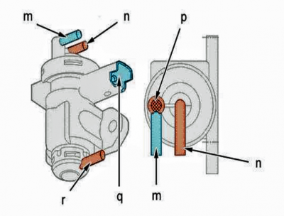

Bear in mind the part you listed above is the EGR solenoid - not the turbo pressure solenoid valve! They have different part numbers...
1618S5 may be the one you want.... part 18
"m" Outlet to boost pressure waste gate (WASTGATE).
"n" Vacuum inlet (via the vacuum pump).
"p" White marking.
"q" Connector.
"r" Atmospheric pressure inlet.
"p" White marking.
"q" Connector.
