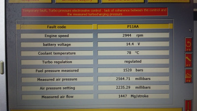

DPs Fault 1 hour before MoT.....
- Posts: 11796
- Joined: 28 Mar 2013, 21:05
- x 1988
I quote:
Lack of coherence between the control and the measured turbocharging pressure.

Fault P11AA
Turbocharger pressure regulation solenoid valve control: Incoherence between the command and the measured turbocharging pressure. Incoherence between the position of the turbocharger solenoid valve and the measured turbocharging pressure for 3 seconds: With the engine running, the airflow must be below 40 kg/h compared with the theoretical flow for 3 seconds.
Downgrade Modes:
Fault P11AA
Downgrade Modes:
- Deactivation of the coherence faults of the flowmeter
- The ECU stops the regulation of the EGR valve
- The engine ECU limits the fuel flow
- Deactivation of the speed limiter
- Deactivation speed limiter until the next time the ignition is switched on
- Deactivation of the cruise control
- Deactivation cruise control until the next time the ignition is switched on
- The activation of the regeneration of the particle emission filter
- The ECU stops the regulation of the turbocharger : Change to piloted mode
- Noise
- Diesel fuel consumption a bit higher
- Lack of power
- Turbocharging pressure sensor
- Turbocharger position copy sensor
- Vacuum problem
- Variable geometry of the turbocharger jammed in the "maximum turbocharging" position
- Turbocharger: Damaged
