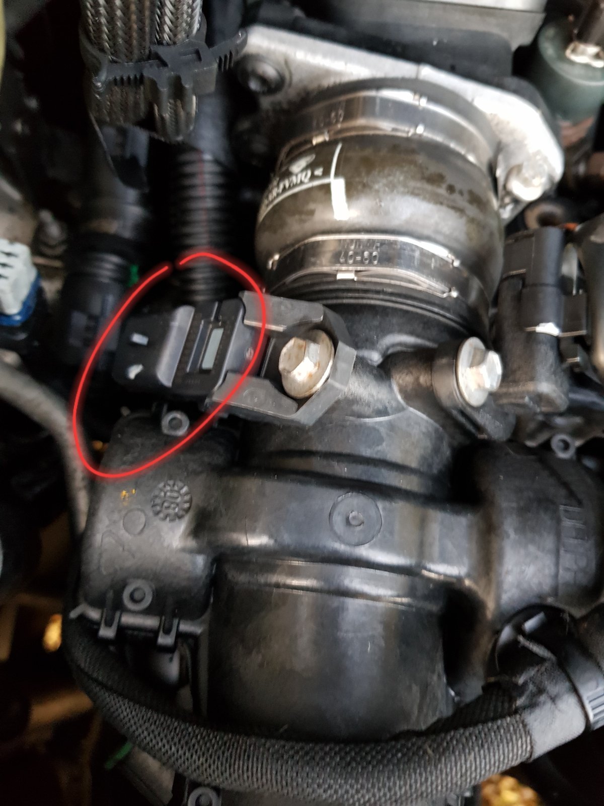

Tried disconnecting various things, best result came from unplugging the circled plug , van would then rev quite freely up to 2500 as before and haul down the road sluggish in 4th up to about 35-40 mph. Another observation, though could be spurious , when reading all the various parameters on the android code reader, the last reading was water temp at -40 degrees C (minus 40) gauge on the dashboard was working fine, would it get a signal from the Ecu ? Or is the gauge independently analogue signaled

Unplugging the map sensor gives a flat reading of 988.24 mbar and engine rev's freely, connect and it rev's erratically depending on pedal position between 800 and 945 mbar(ish)
