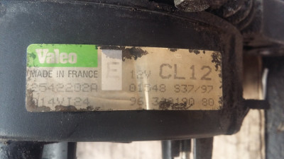

Need a source for Valeo alternator parts....namely a CL12...this one. I am struggling to find one that has any sort of list I can select from.
I need a bearing set, slip ring and brushes

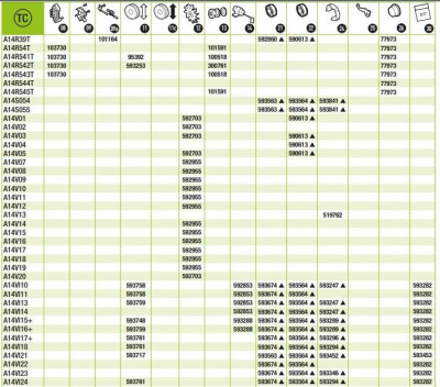

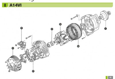

Found the catalogue on Valeo site... Looks like not all parts are available, well not from Valeo anyway....
Exploded diag
The label says A14VI24 which is the bottom row in these tables
Presume 2 is the brush pack and 21/22 the bearings (although 22 doesn't appear on the diagram!) Slip rings not available separate from the rotor (bet that's expensive!). Items marked with a triangle only available in packs of 10 by the looks of it!! I would expect you can get the bearings aftermarket anyway if you measure them (or they are on e-bay if you search under the number).

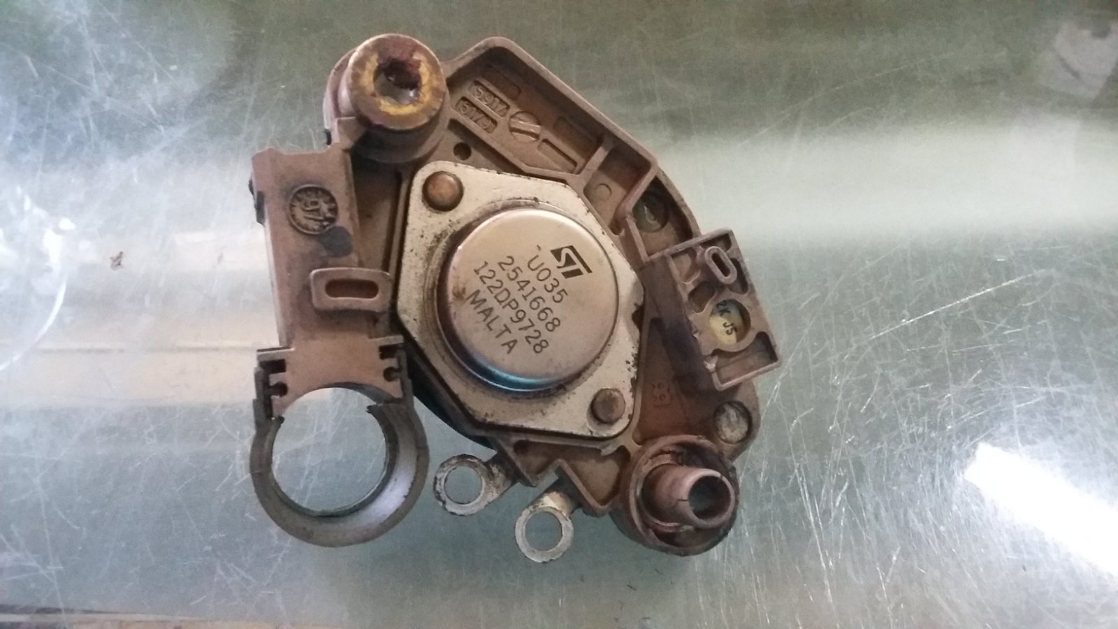

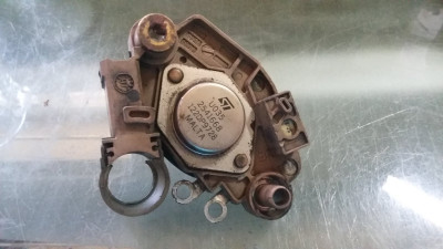

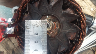

This is what I have

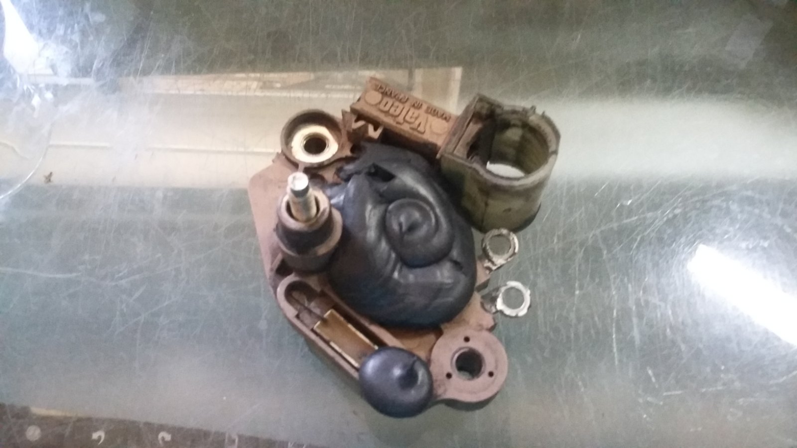

Posts: 11851
Joined: 28 Mar 2013, 21:05
x 2006
Re: Source, Valeo alternator parts
Unread post by Stickyfinger »
x 3565
Stickyfinger wrote: 23 Jul 2019, 15:17 Just pulled the small bearing, it is 35x15x10 (9?)
A 6202-2RS equates to 35x15x11

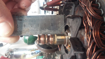

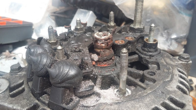

Shaft/slip ring
x 2938
For entertainment it might be ok but is it really worth it? I've done quite a few but the results can be very hit and miss.
