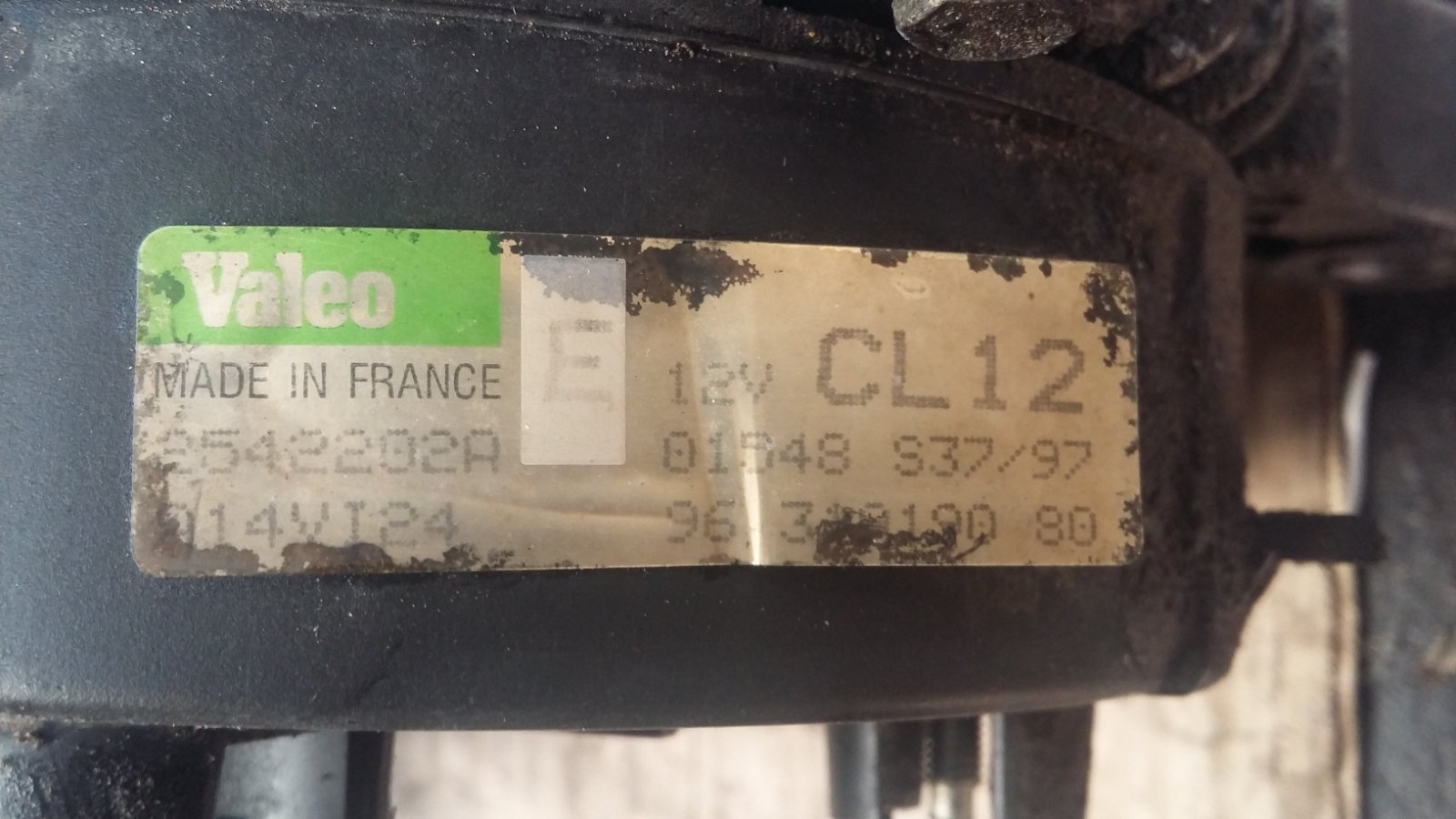

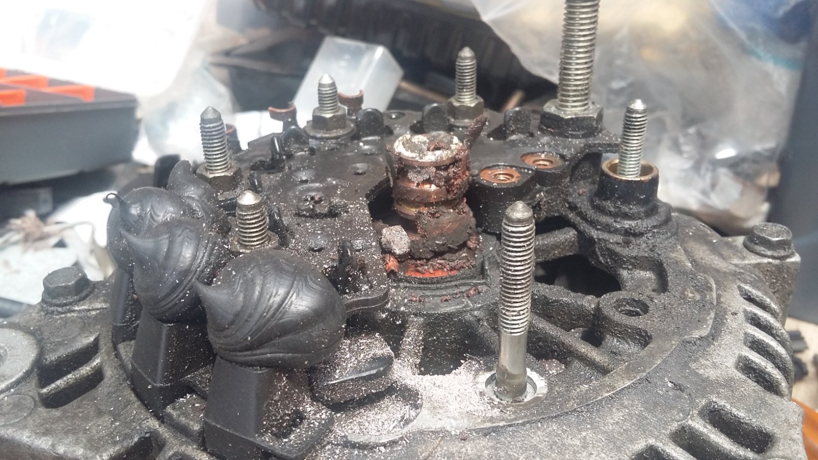

Need a source for Valeo alternator parts....namely a CL12...this one. I am struggling to find one that has any sort of list I can select from.
I need a bearing set, slip ring and brushes

The Valeo part number for this alternator is 9631919080
Valeo list 2 CL12 models in their catalogue:
433202 & 433204 (Exchange reference numbers)

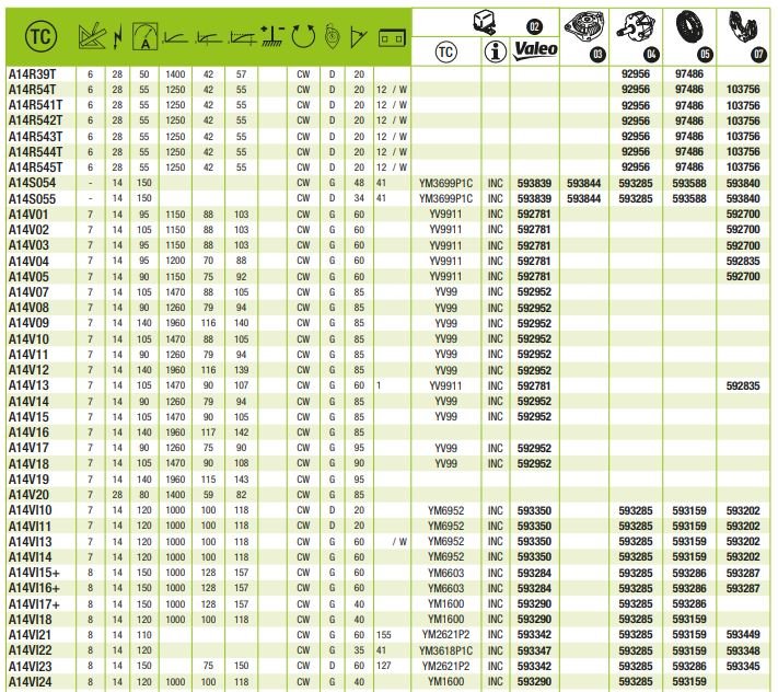

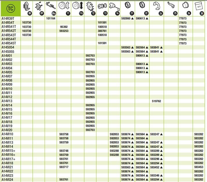

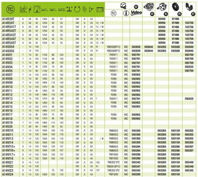

Found the catalogue on Valeo site... Looks like not all parts are available, well not from Valeo anyway....

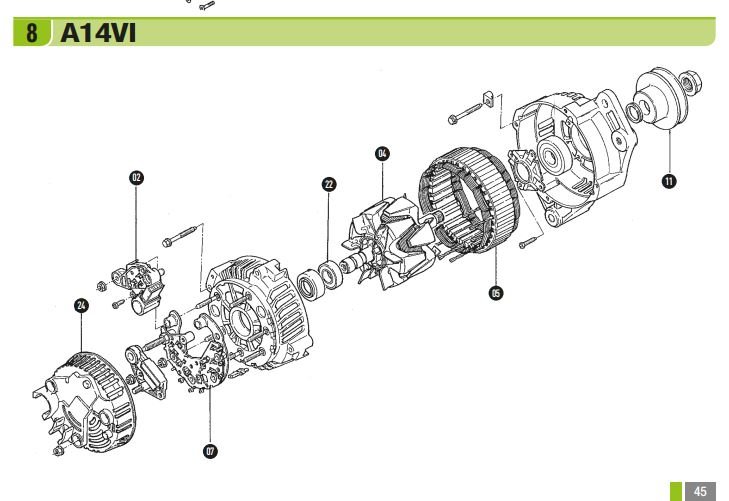

Exploded diag
The label says A14VI24 which is the bottom row in these tables
Presume 2 is the brush pack and 21/22 the bearings (although 22 doesn't appear on the diagram!) Slip rings not available separate from the rotor (bet that's expensive!). Items marked with a triangle only available in packs of 10 by the looks of it!! I would expect you can get the bearings aftermarket anyway if you measure them (or they are on e-bay if you search under the number).

Bearing #22 seems to be a 6202 2RS C3 - common as anything and cheap.
Bearing #21 seems to be a 17x 17x 52 2RS https://www.ebay.co.uk/sch/i.html?_odkw ... g&_sacat=0

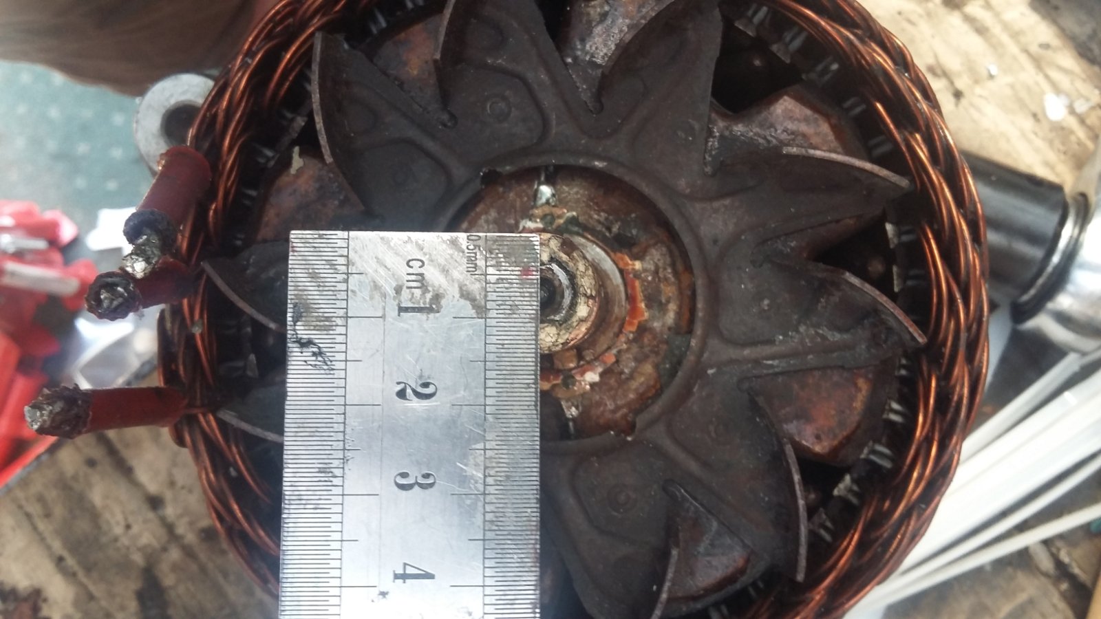

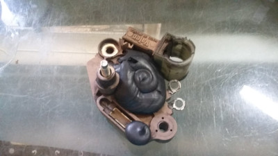

This is what I have

Just pulled the small bearing, it is 35x15x10 (9?)

Stickyfinger wrote: 23 Jul 2019, 15:17 Just pulled the small bearing, it is 35x15x10 (9?)
A 6202-2RS equates to 35x15x11

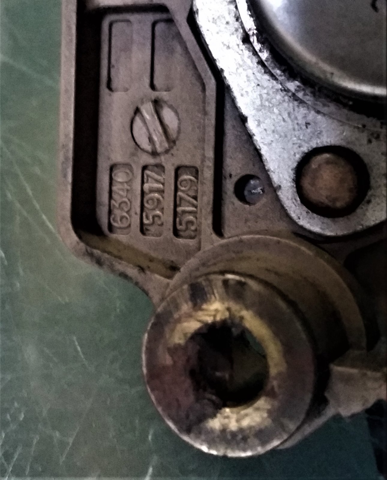

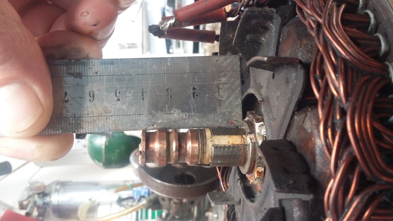

Shaft/slip ring
