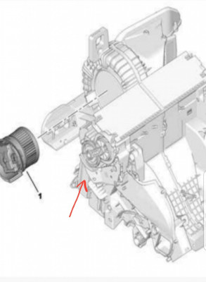

Let me see I got it right.
Can you please take a look at what I marked, would that be the inner filter? Because I've seen it on deep bottom left side near the pedals.

Re: Citroen C5 AC blower location
If you are referring to the Pollen Filter, then yes - the cover for it is shown here, item 6 and the filter is item 5 that slides in.
