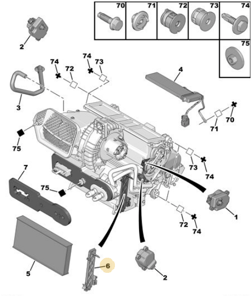

Re: Citroen C5 AC blower location
If you are referring to the Pollen Filter, then yes - the cover for it is shown here, item 6 and the filter is item 5 that slides in.
