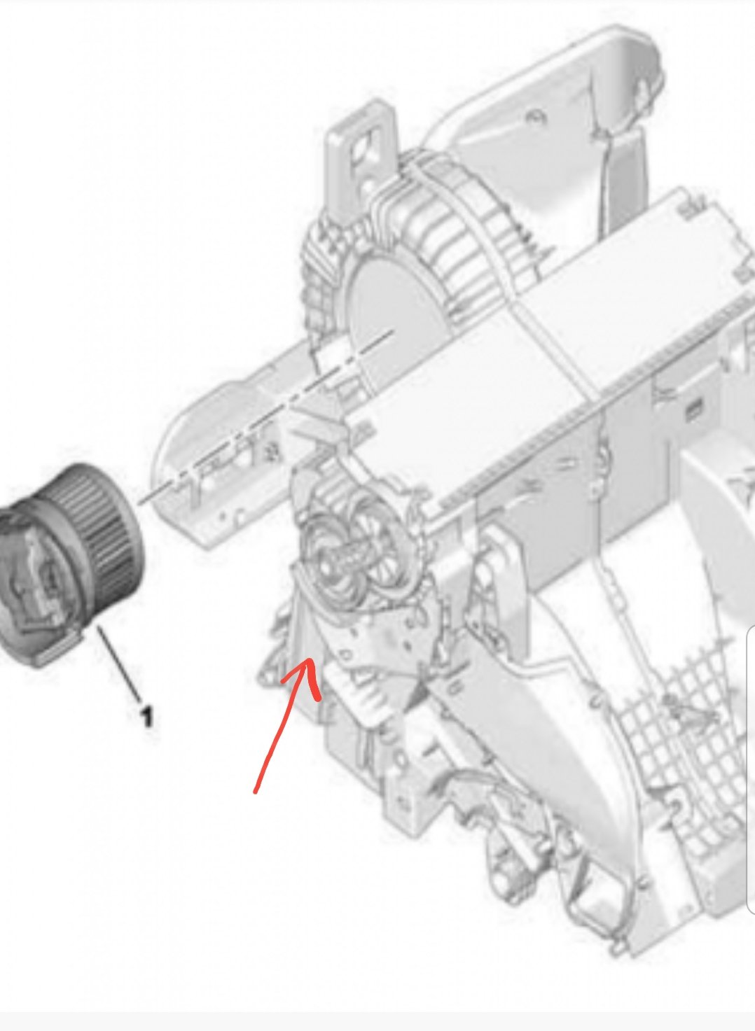

Hi all,
Love this community, great pals.
I have a C5 2006 2.0 petrol, left side driver, I believe you call it mk2.
The interior AC blower has a great vibration while at it's highest speed.
I've searched the entire network but couldn't find the blower location neither how to remove it.
It's either faulty or has some staff in it.
I saw a cyilinder like shape behind the main console, at the bottom. Not sure it's the one, nor how to access it.
Thanks a lot in advance,
Eitan

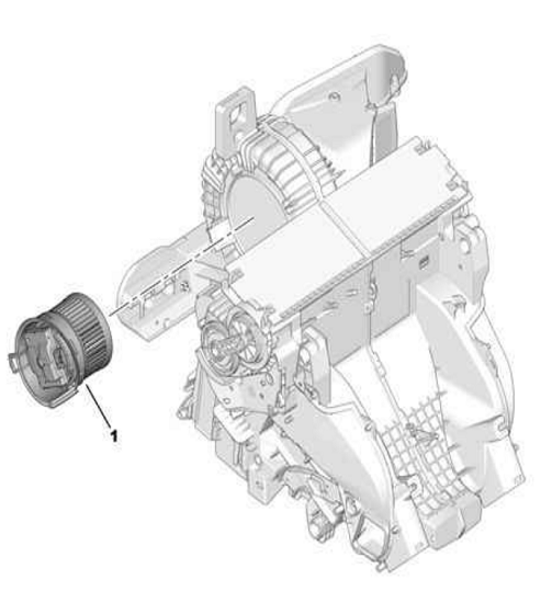

You have to remove the fascia to get at it = but unfortunately there is no indication of what part they are referring to - but it is on the left hand side - so I suspect you would need to remove the right floor trim panel by the foot pedals to get access

Eitanp
Posts: 9
Joined: 01 Jul 2019, 06:08
Location: Israel
My Cars: Citroen C5
Ssongyang Rodius
Re: Citroen C5 AC blower location
Post by Eitanp »
Thanks a lot,
Let me see I got it right.

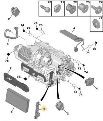

Can you please take a look at what I marked, would that be the inner filter? Because I've seen it on deep bottom left side near the pedals.

If you are referring to the Pollen Filter, then yes - the cover for it is shown here, item 6 and the filter is item 5 that slides in.
